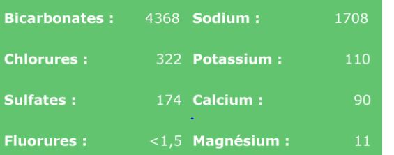

Hi, can one use wtaer with high level of sodium instead of a product like PFH1500?
PFH 1500 is 1500mg/L of sodium
Spakling St yorre water is 1700mg/L
As a sodium preload it could be a good alternative and maybe a good source of electrolytes during the race?
I am not familiar with these waters, but 1500 mg/l is 1.5g/ liter sodium or 0.15% sodium per liter…sodium chloride (salt) is 39.3% sodium therefore 0.38g salt per 100 ml water or 3.8g salt per liter water.
Not sure I would buy salt water, but sea water which is very salty is about 35g salts (mostly sodium chloride) per liter. Sea salt is a good option if you want electrolytes beyond sodium but really sodium is all you really need, the rest ???
Dr. Alex can comment better on how much because it depends on things he is expert on.
composition of st-yorre :
