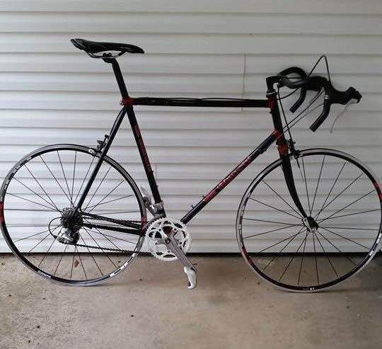

This was the FB pic by the seller:

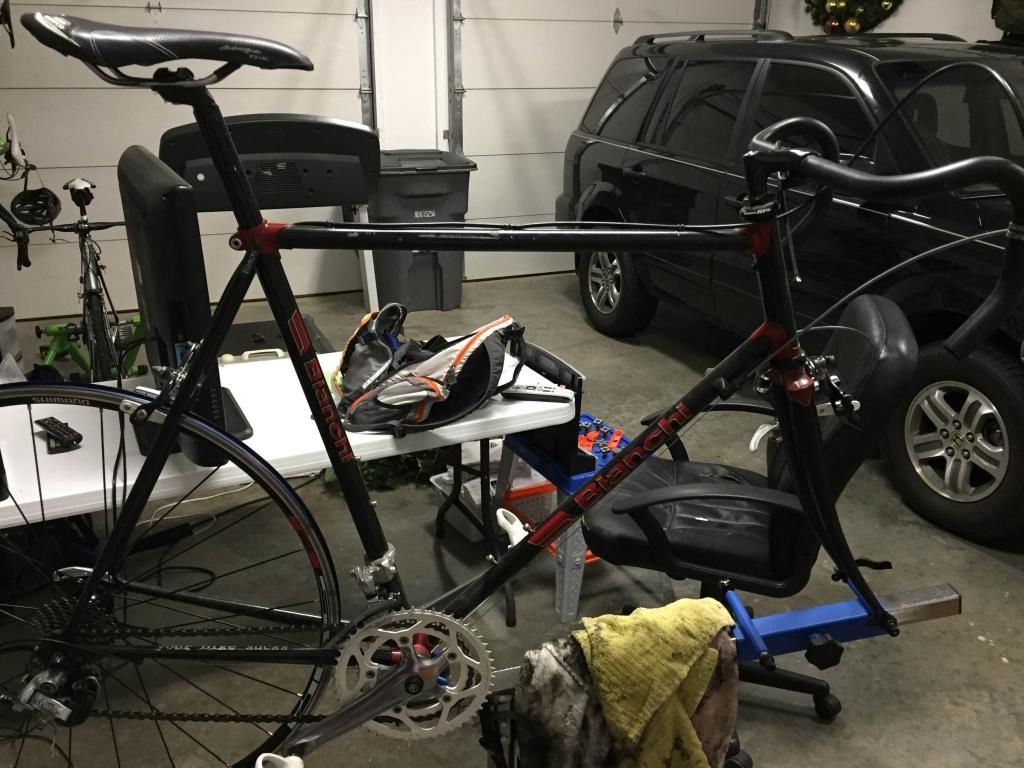

Got it home:
http://i1247.photobucket.com/albums/gg622/razorbacksteve/IMG_0046.jpg

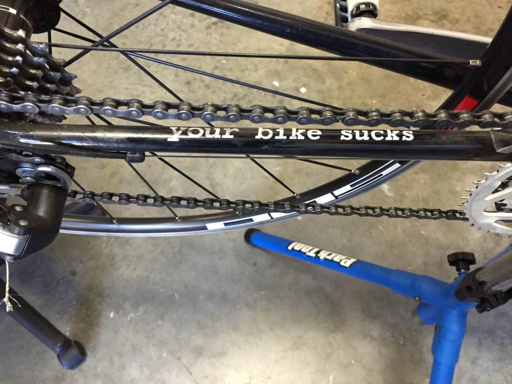

Didn’t notice this nugget till I got home, it looks original:
http://i1247.photobucket.com/albums/gg622/razorbacksteve/IMG_0076.jpg

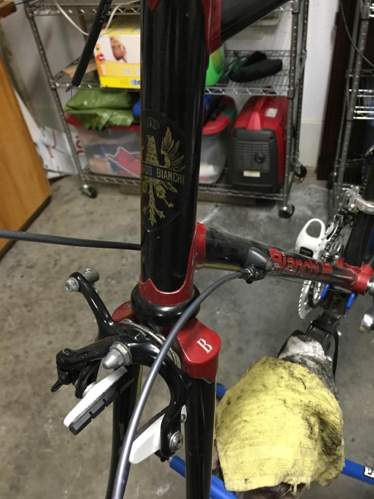

Wish it had more of a headbadge, but still kinda unique:
http://i1247.photobucket.com/albums/gg622/razorbacksteve/IMG_0048.jpg

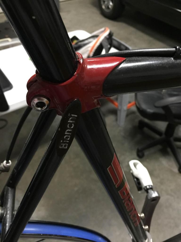

Seat cluster:
http://i1247.photobucket.com/albums/gg622/razorbacksteve/IMG_0050.jpg

The componentry is junk, and definitely not original, outside of maybe the BB and crank (although the chainring has been painted white??). I’m thinking I’m going to strip it down, convert it into a touring/rain/gravel/commuter ride. Something more comfortable than the race roadie, but still worthy of a century tour effort, commuting, and riding w/ wife and no-drop rides.
I’ve got some 10 sp 105 parts I think I’m gonna load it up with. Remove stickers off the wheels and put maybe some 28 mm Conti Grand Prix 4 seasons? Red bar tape, maybe.
I think, based on a bit of googling, and the serial number, JS682194, it’s a 1994 frame, probably made in Japan. I believe it a 70 mm Italian threaded BB?
