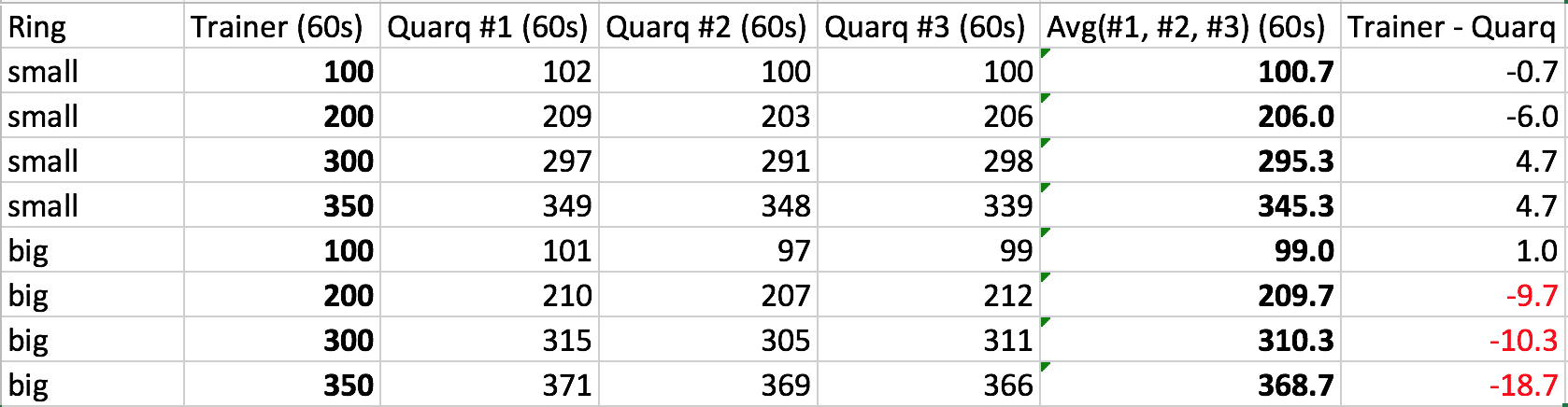

The evidence is all in this table:
Test details:
1 minute intervals comparing the power from crankset Quarq power meter vs 1 minute at Zwift ERG-mode interval set wattage.

New to Zwift and direct drive trainers. But in the first couple races I did I noticed that I had a super tough time putting out wattage in the big ring. I thought maybe I just wasn’t used to the trainer. But once I did several of the workouts in ERG mode I realized that hitting wattage targets in the small ring was way easier than in the big ring. For high wattage intervals it felt like I was putting 30+ extra watts when in the big ring. So I decided to collect some actual data. And as the table above shows, there is some evidence that at high wattage 300+ (and perhaps exponentially increasing) the trainer under-reports wattage.I will note that for the data I collected I would roughly estimate I averaged ~65 rpm for the big ring intervals and ~75 rpm for the small ring intervals.

In short - What’s causing your issues here is the trainer flywheel speed. ERG really doesn’t work that well when the flywheel is SCREAMING along at a few 1000rpm (or so…). The FLUX units are notorious for this. Related to the brake strength and how the units measure power. Your on-bike meters will be closer to accurate than the FLUX. I’ve added a basic flywheel/ERG speed test to the tests I do… almost every trainer fails to hold 225W ERG in the 53/11… or if it does, the power reporting isn’t as accurate as it is with a slower flywheel speed.
If you want a more reliable data set, repeat the test but don’t use ERG mode and record during steady state, not including significant accelerations as you would have during a 1 minute ERG controlled interval. You don’t need to test at an exact figure. Just pedal consistently at around 100W, 200W and 300W or whatever range you want to cover, and record power data from both the trainer and power meter for comparison. Remember that the trainer and power meter both have declared accuracy tolerances, and that the two devices are measuring different things. The trainer is measuring power at the rear hub and a crank based PM is measuring almost your entire output, missing only any small losses at the pedal bearing.

It doesn’t even need to be half that total error to explain his data in my opinion.
Let’s assume those 100W, 200W and 300W figures are exact according to the trainer’s measurment? There could easily be say 10W lost in the power train at the 300W range. That only leaves a 8.7W differential for his biggest gap. 8.7/300=2.9% total error. I think the Flux and Quarg have declared accuracies of 2.5% and 1.5% repectively. That’s 4% when comparing data between the two. It only takes 2.9% to explain the OPs results without anything being out of spec, assuming 10W lost in the drive train.
The difference between small and large ring may be a separate issue, likely due to a flawed test method (ERG), and that can easily be checked.

  2. This is a known issue of the Neo, which is essentially the same basic system as the Flux S. It is down to issues of the power at different axle speeds. There was another post on here about a year back with this exact issue. (edit: 2 years ago almost exactly)
  3. There is a difference from the quarq (I have 3x quarqs, they all do this) between inner and outer rings - demonstrated by calibrating back to back from the inner and outer and you’ll get slightly different calibration. Only slight though, later units better than the old ones.
