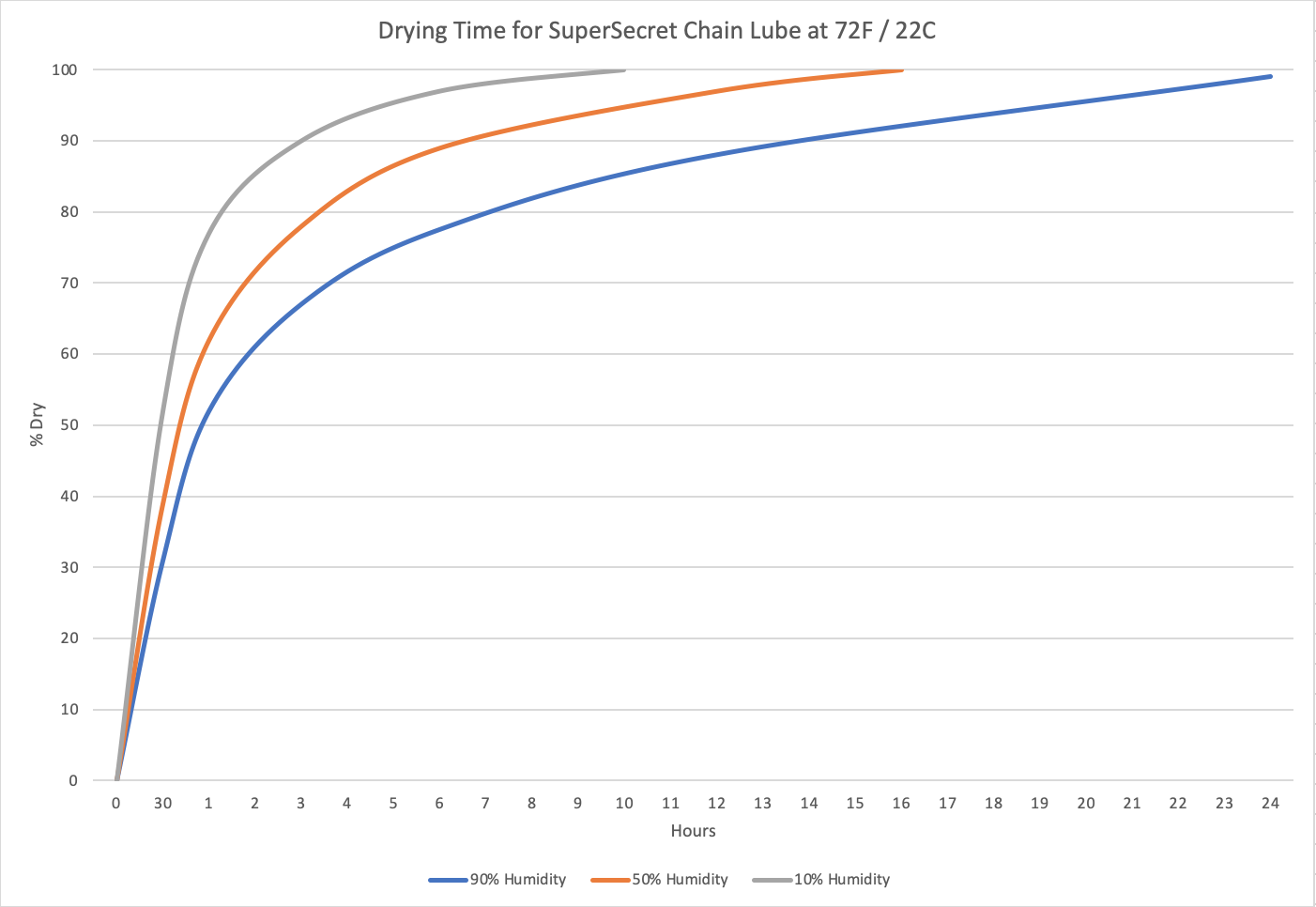

We are just a few days out from Adam at ZeroFrictionCycling posting his report on the stuff, and wanted to update everybody on some things we learned during his testing. First of all, lowest wear EVER for a drip lube… and of course, first drip wax to fully penetrate as he has previously reported. We are lowest wearing drip by far in blocks 1-3 including dusty-sandy conditions. However, we got some interesting wet results, which were still good, but not as good as we hoped, though looks like we will still rank as the lowest cost per KM lube, best dry performance, etc… I’ll let Adam explain in his update, but it seems that our initial stated cure time was just not enough to allow the lube inside the chain to fully harden, which was good enough to be the best drip lube in ever in dry conditions, but in wet, it was allowing the water to penetrate and dilute the lube somewhat, making it only the 2nd or 3rd best ever :wink: A subsequent study here showed that we were just underestimating the drying time based on lab testing in ideal conditions and that in the real world of the garage, it is taking 12-24 hours to fully cure/dry and not the 2-8 hours we saw in the lab.
Anyway, we’ve updated our use guidance to include a minimum 12 hour cure in dry/warm conditions and 24 hour cure in cool or wet conditions. So if you are one of the people in cold wet climate who were experiencing spotty results, this is THE solution!! We now know that for the ZeroFriction testing we were only achieving about 75-80% cure and will be re-testing with Adam to see how much better we can be at full cure!

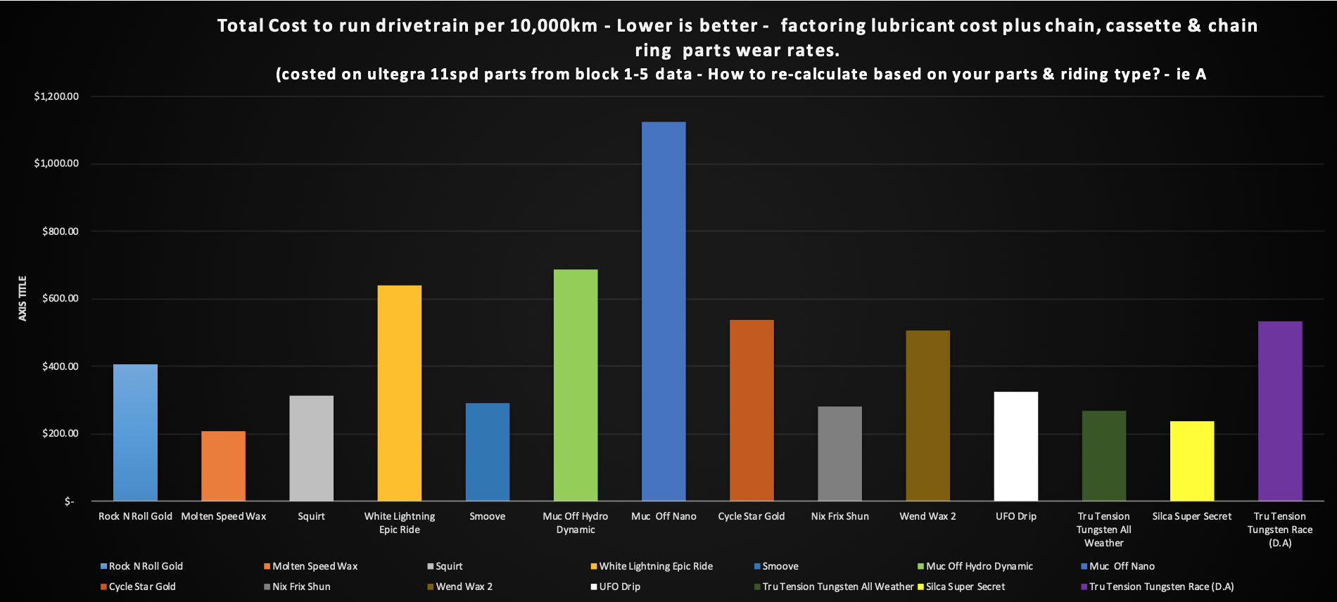

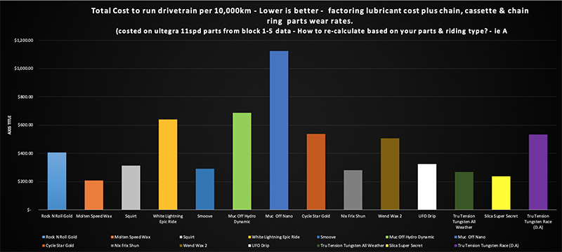

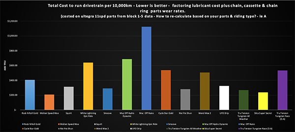

For those of you waiting for the ZeroFriction results, they are now live: https://zerofrictioncycling.com.au/lubetesting/
accompanied by his longest ever review at more than 40 pages!!
Reader’s Digest version:
First and only wax based drip lube to fully penetrate in on-bike application (all others require removal of chain and immersion)
Lowest wear ever recorded in dry, sandy, loamy conditions.
3rd best in wet/dirty conditions (but we now know the lube was not fully cured for any of this testing so soon to retest)
Even with only partial cure, lowest cost per 10,000km of any drip lube ever tested
One of only 5 lubes to make it to Block6 of the test

someone needs to make a cribs version of all of Adam’s reviews. Testing regime 10/10. Succinctness: 2/10
