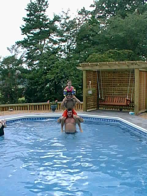

In-Ground Pool
16 ft x 32 ft with 10 ft max. depth
Steel Sides, Gunite Bottom, & Vinyl Liner
Diatomaceous Earth Filter & Chlorine
The Good
  • Terrific entertainment for the kids.
  • The deep area is a must have for teaching kids to fetch coins off the bottom.
  • The D. E. Filter with Chlorine is cheap and effective.
  • No worries about leaks due to concrete cracks with a vinyl liner.
  • Replacing the vinyl liner results in a new pool every eight years.
The Bad
  • No line on the bottom for keeping on track when swimming laps.
  • A flip turn after every sixth stroke.
  • The vinyl liner only lasts about eight years.
  • Constant worry when on vacation away from home.
  • It will cost money to tear it out when the kids are gone.

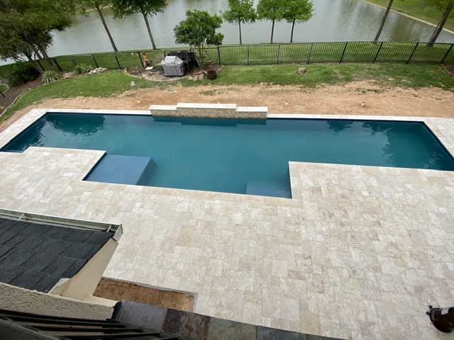

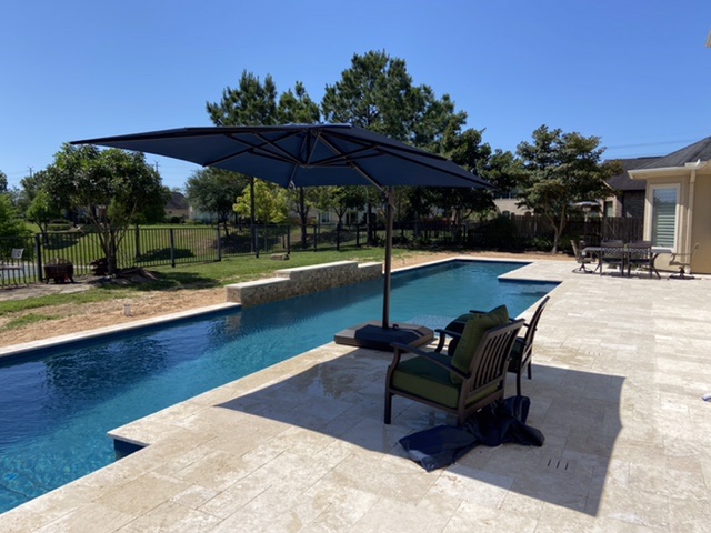

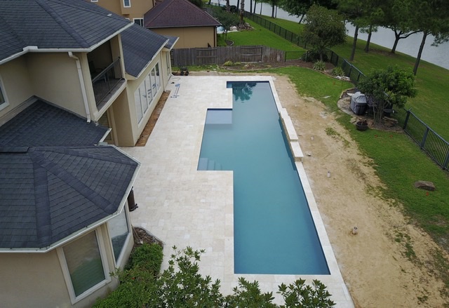

Here are a few photos. The water color is actually much more blue than shown in the first two pictures, which was on a cloudy day and also when the plaster was new. The last photo shows the actual color now. The yard is still a mess while I get the sprinkler system reinstalled and then landscaping redone.
I also posted a thread that followed my construction process. It’s worth a read because of the great input provided by others who also have pools designed for real swimming.
https://forum.slowtwitch.com/forum/Slowtwitch_Forums_C1/Triathlon_Forum_F1/Building_a_lap_pool_-_design_questions_P7122067/?search_string=lap%20lane#p7122067
One benefit of gunite is the ability to add tile. I put spotter tiles along the swim lane every 18 inches along with the typical row of solid tiles to mark that the lane is about to end. You can barely see them from above the water but they’re pretty easy to pick up when swimming.
