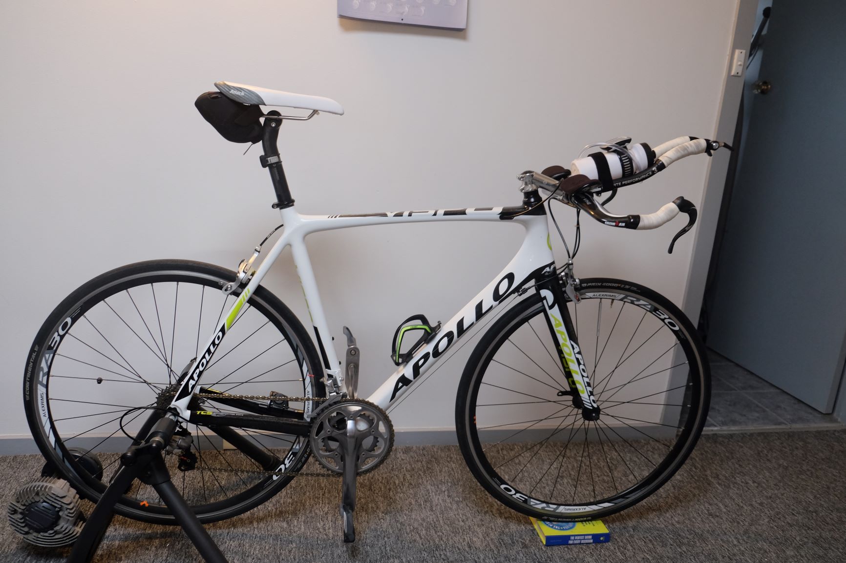

I did the transformation on my road bike for my first Triathlon coming soon.
Like JaretJ says, it’s twitchy.
I have to be calm and and focused to ride well.
Anyways, I never tried a dedicated TT bike, so I can’t compare… :slight_smile:
https://i.imgur.com/jsHaGJGl.jpg
Louis :slight_smile:
