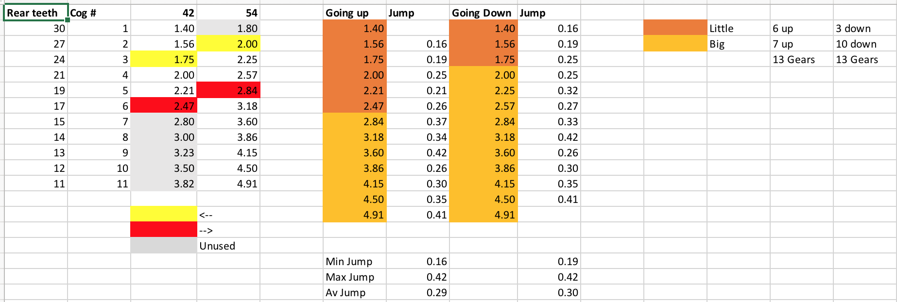

How’s this look, hopefully it makes sense?
My only problem is when shifting down the software wont let you move the FD down until the RD hits the 2nd rear cog. I guess it knows the chain can handle that angle and wants you to stay big for as long as possible. I’d just like the option for me to chose though.
