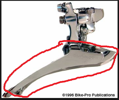

What is the chain slider?
Sorry - its called the “DERAILLEUR CAGE”
this part:
