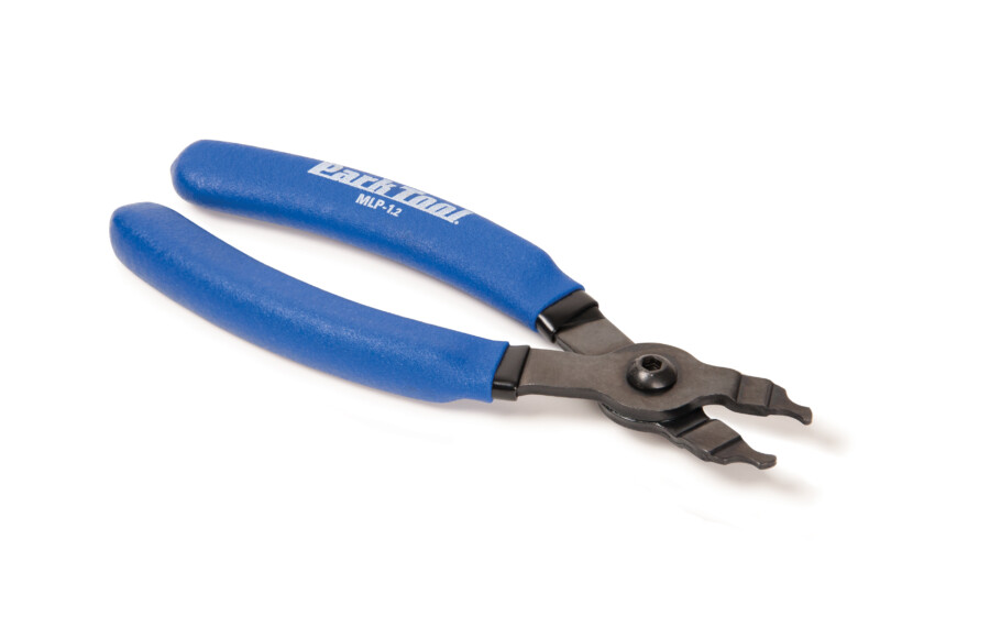

This…

This…
The tool makes it super easy… before I bought the tool I bent a coat hanger and put it on each side of the link and used some pliers to pinch it and release… it worked but the above tool makes it a breeze.
If I were you I would just break the chain and install a new one. Any standard chain breaking tool will work on any of the links. This will also aid in getting the FD set up properly as the shifting won’t be sloppy as a result of an old chain.
I do have one of the fancy tools designed specifically for this job but if the power link is really tight you will probably damage it even with the pliers. These links are not designed to be reused and are easily bent.
