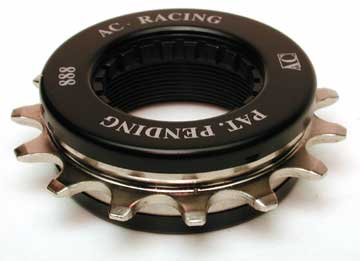

Apparently this is what I need:
http://www.sheldonbrown.com/harris/images/ac-15-tooth.jpg
The question is, can this be spaced outward somehow so that I can dial in a decent chainline?

You can probably buy a one speed “BMX” freewheel from your local bike shop. Beware of the BMX “flip-flop” size. Not to be confused with other “Flip-flop” hubs. The BMX flip-flop hub has one side that is a smaller diameter to accommodate a 15 tooth freewheel. This freewheel will not fit a standard threaded hub. Stick with the 16 tooth and up model and you will probably be fine.
