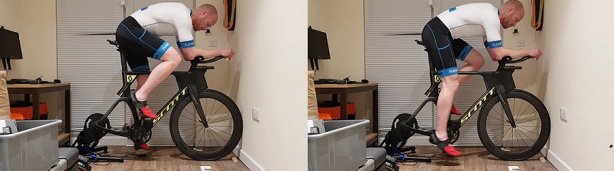

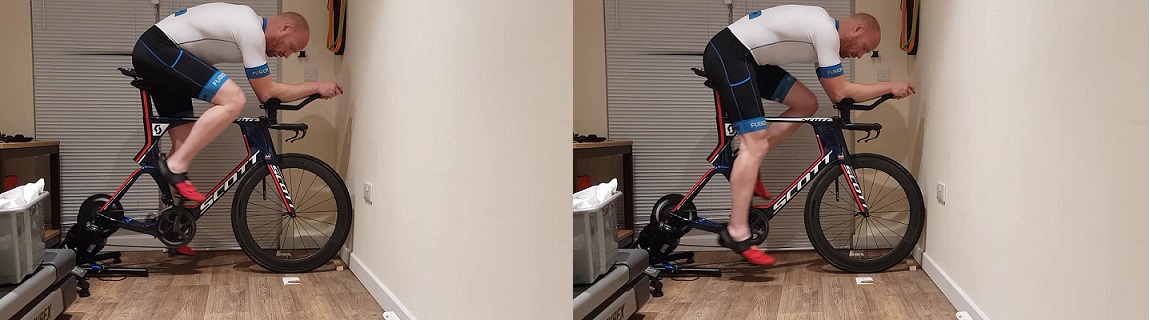

Played around with the XL Plasma tonight, tried to get as close as I could to suggested fit on the Ordu and this is what I came up with.
Ordu setup
Scott Plasma below
Scott Plasma XL - Saddle 865mm , Setback 75mm , Stack 675 , Reach 510 - Doesn’t feel as low on the front end as the Ordu.

Like pbnz above I’m 6’2 and ride a size large Scott Plasma. I don’t have my current stack/reach numbers handy but my old numbers were: x 527, y 678, which is very similar stack to what you listed and a longer reach but I have a lower saddle height (822). Here’s a picture of that position on the size large Plasma.
I’ve since made a few changes to my position (shorter crank, correspondingly lower saddle height, a bit more reach after getting new PD Ergo arm cups, removed all spacers).
Are these captures while you’re in motion or were you not moving (and just posing) in these photos?
All while moving.

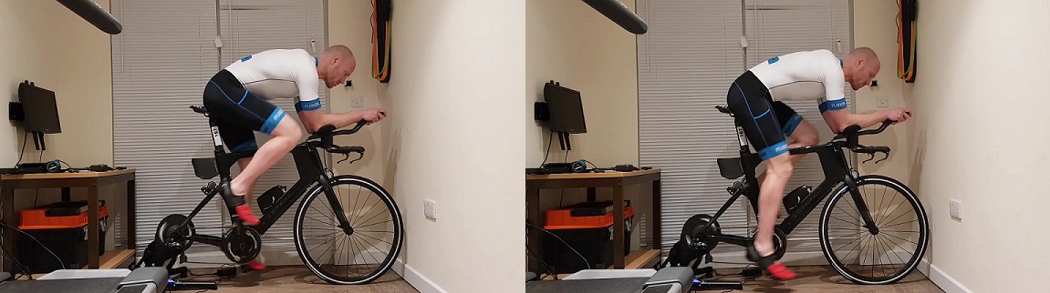

Scott Plasma Large, Didn’t have time to get the numbers quite right, the extensions need to be swapped for longer ones.
Your saddle is a touch high. Drop it 1 cm (and drop the cockpit 1 cm to match).
Slide your elbows forward on the pads just a bit as well. The longer extensions will help that.
I still say you need the XL Scott Plasma w/ TT stem.
Why save 1 watt with the bottle when you’re losing 10 or 20 due to a bad position?
And yes, you’re seat is too high.
All while moving.
this is the correct bike.
Personally I think the Large looks small under me but maybe its just because the fit pads etc aren’t in the right place or I’m just a big lump.
Eric would you say the XL Plasma looks a better fit than the Ordu ? I appreciate these are only still images but after all this fuss its not unlikely I just stick with the Ordu and refine the fit a little more.
I think the XL Plasma and the Ordu fits look the same to me. I’d choose based on aerodynamics and cockpit adjustability… you need one that will give you some pad tilt.
