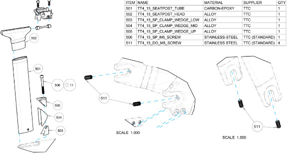

Just as for the rear, you have two screws in the fork when you remove the wheel to adjust the distance of the wheel from the bottle / the tilt if your wheel is not in line with the frame.
Let me know if this solved it / if you need a picture . Below, from the manuel, look on the right, screws are ITEM 511

Genius!!!
I just unscrewed those a few turns and that solves it!!!
I will remove them entirely and add some fresh loctite and reinstall them.
Do you happen to know how many millimeters you have exposed on yours? Mine are now a couple mm exposed and I want to make sure I’m not adding risk of failure by having them too far out.
Around 1.5 mm, I guess it will depend a lot on the tire used.

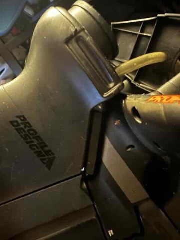

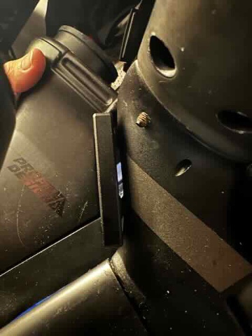

I was wondering about those screws as well, the other ones I was thinking to check were the mount for the actual bottle itself, as if there are spacers etc in there is will lower the height of the bottle. See pics attached for what I was referring to!
Good luck with the bike, they are great, fast machines.
Thanks for the pictures. I will check for those spacers on the mount screws, too. It would not surprise me to find them missing because my fork screws are out now about 3.5mm to prevent the wheel rub, so it seems like something small elsewhere could also be contributing to the issue.
