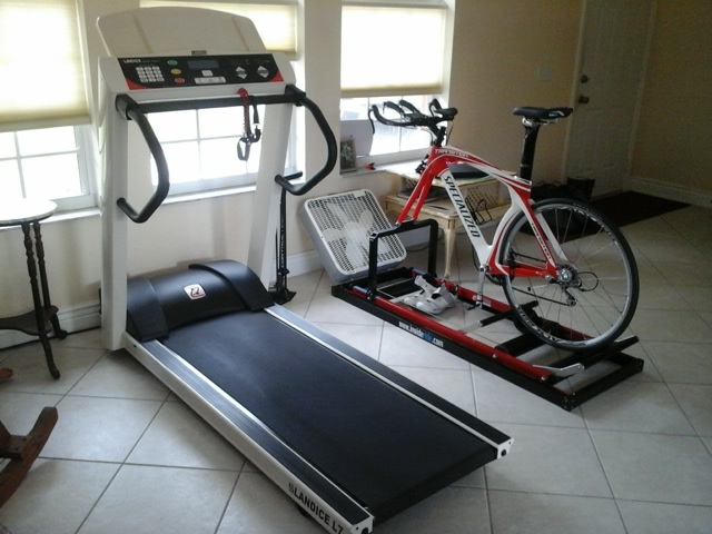

Thanks, the belt feels soft and up close cannot see any cracking at all . Is there a method of testing or just a visual inspection ? The tread on the belt looks new too .
Pic below!
