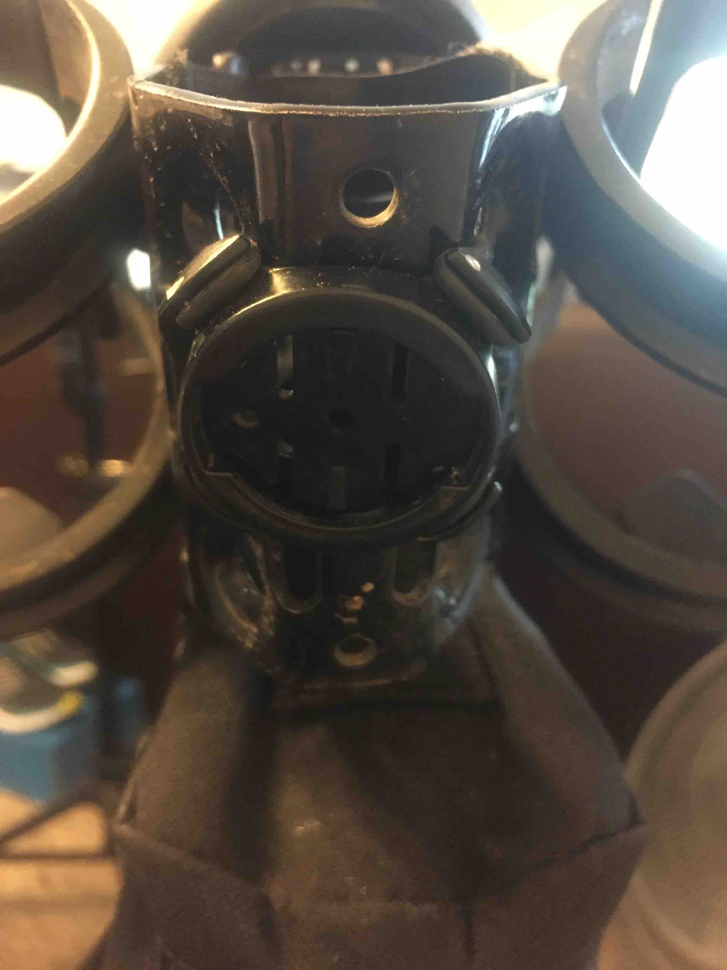

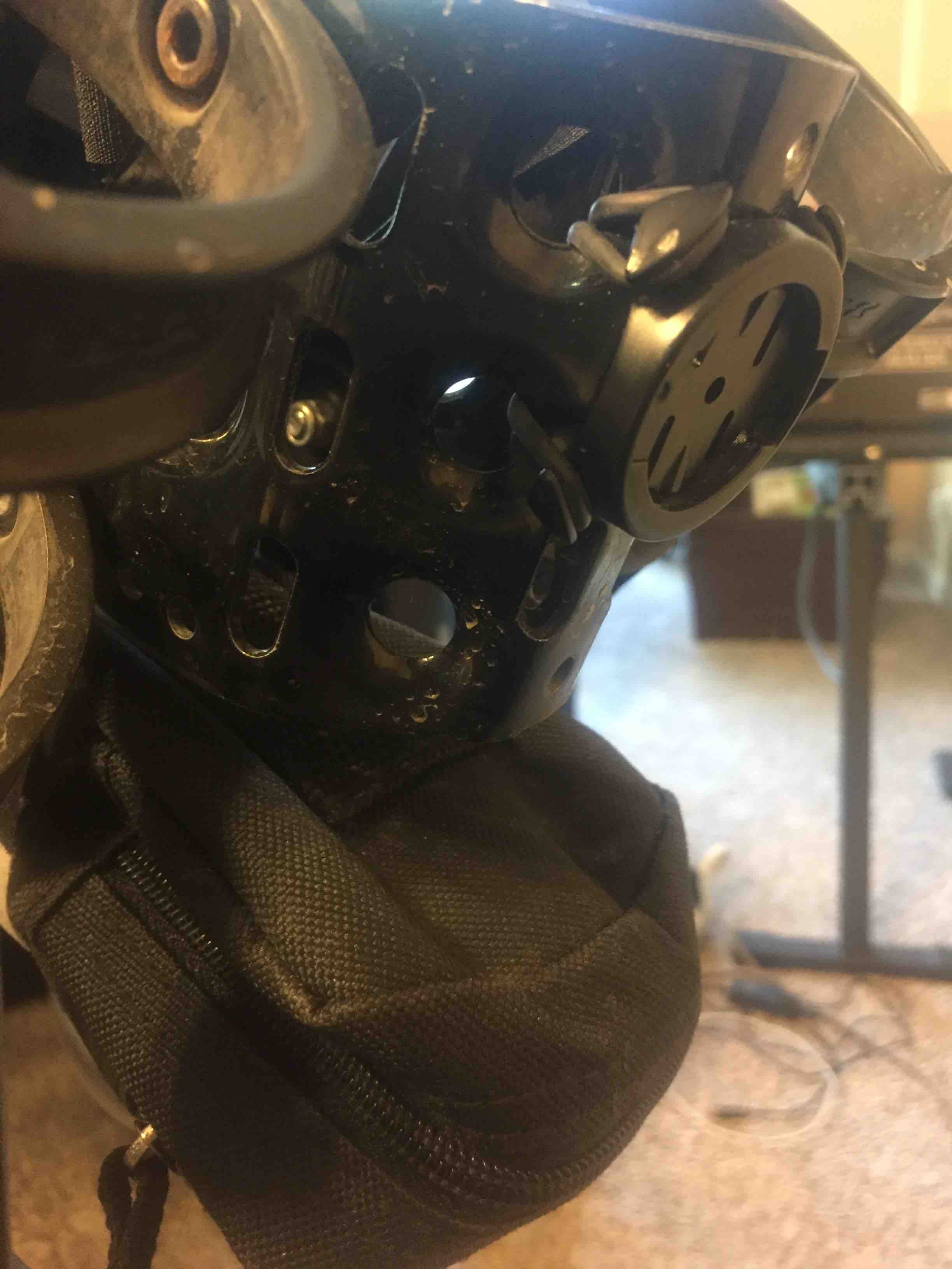

I just went through this looking for a way to mount my Varia off a single cage rear hydration mount. I used an integrated stem mount I played with. I tried an inexpensive plastic one I found on Amazon but the 2 mm screw for the mount stripped so the Varia turned though I liked the Varia location.
So I ended up with this one listed below on ebay for ~$ 16 & shipped quickly from US that I attached between the rear hydration mount & the bottle cage using just one of the bottle mount screws. While carbon fiber the mount piece has 2 screw thread points which can be reversed to the back side of the long piece. That way the bend came out below the bottle cage. I then set it up so the Varia is horizontal & it works well & is secure.

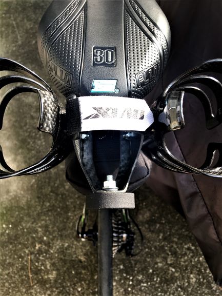

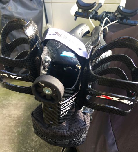

I just used the included mount and was able to attach it to my xlab super wing
That looks very interesting! I’d like to do that. Doesn’t it angle downward reducing the radar performance?
Nope works perfectly fine and haven’t noticed a difference. However I don’t ride outside that much. I like this setup because It doesn’t affect my race setup
So I finally got this all done (shapeways took a while to come in).
I went with an Xlab Carbon wing and a shapeways printed 1/4 Turn mount. (https://www.shapeways.com/product/FB2LYR4A2/garmin-eighth-turn-socket-flat-mount?optionId=70043641&li=ostatus). The medium size is drilled out in the middle so you can use an appropriate bolt which will recess into the mold.
