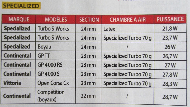

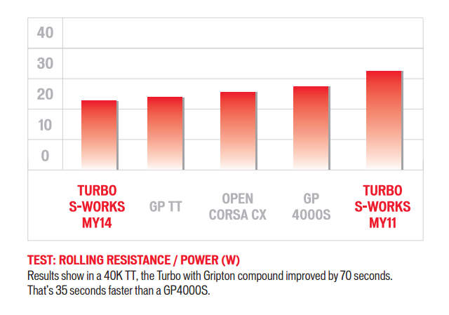

I bought the SWorks Turbo 24c tire in 2013 (I read at the time very good results from an independent test of the Finnish company Wheel Energy):
To be fair, Specialized produced a new version of the tire after (2014?):
But Rolling Resistance test proves again that the Crr is higher than a GP4000S2 (same Crr than GP4000S, I believe):
http://www.bicyclerollingresistance.com/road-bike-reviews/specialized-s-works-turbo-2016
Definitively, this tire is a mystery (or Specialized test protocol advantages their tire).
