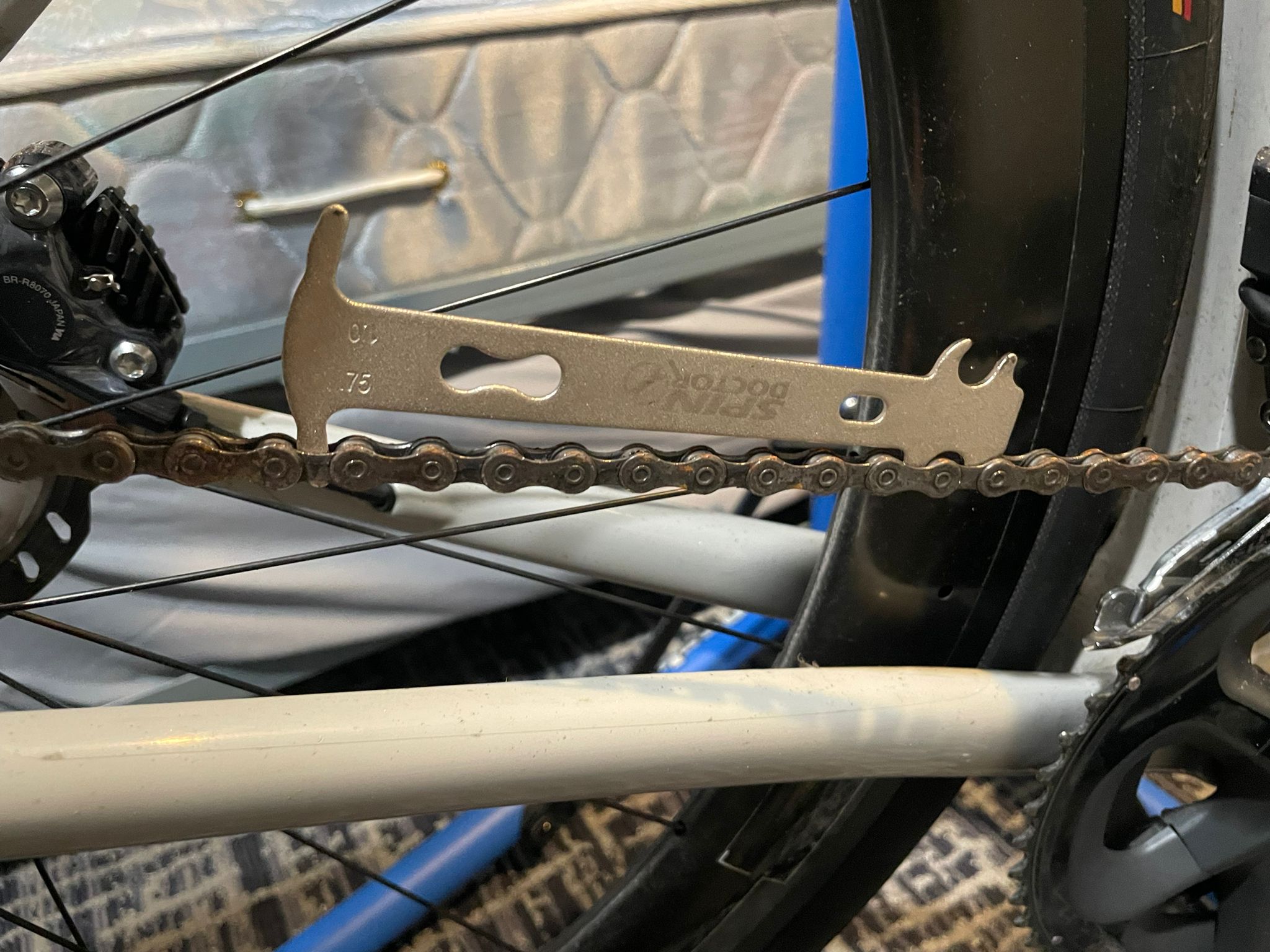

It’s kinda tough to tell from the angle of the picture you posted, but it sure looks from the way the chain is sitting on the chainring that your chain is pretty much toast, or your chainring is, or both. Have you measured your chain?
Corollary to this… you mention that you bought the chain on Amazon… are you sure it’s an actual Shimano chain? The fakes are absolutely running rampant on there, and things like inferior plating and heat treatment - plus really quick elongation - are definitely to be expected with the fakes.

My chain was purchased from the “Shimano” store on amazon, which I assume (i know…) is legit. It certainly hasnt stretched - see pic
Yup, length looks good.
“Shimano store” on Amazon just means that someone is selling a product that they claim is made by Shimano. There’s no direct affiliation with Shimano. Based on the link you posted, here’s the actual sellers page on Amazon, and it’s worth noting that there are several one star reviews from people claiming that they were sold counterfeit Shimano products, including chains.
Frankly, I’d be surprised if you actually got a real chain from that seller.
