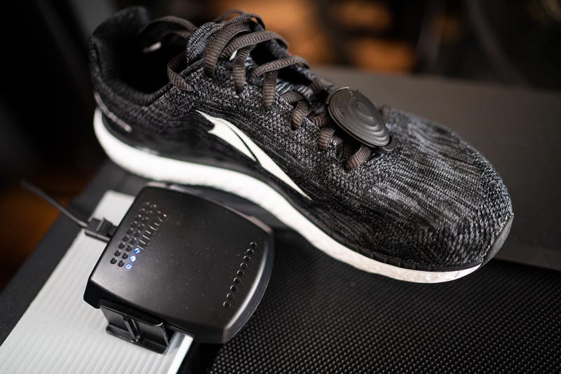

Running on Zwift is still nowhere near as fun as riding on it, but the convenience and safety in these troubling times is a huge benefit. I’ve been doing a lot more bike-to-run brick sessions on Zwift and Runn made it even more compelling.
After three months of Zwift running with Runn, I decided to write a step-by-step guide and an in-depth review. Runn really does track pace and distance precisely, but only if you take the time to carefully and thoughtfully set it up. It is not a plug-n-play device. But once mounted and calibrated, it is a convenient “just works” experience.
Check out the full review with lots of photos and thoughts here:
Runn Treadmill Sensor Review after 3 months of running on Zwift
There is room for both Runn and Stryd to exist in the market. I have both and like them for different reasons. Stryd is portable and easy to transfer from shoe to shoe to run on a treadmill or outside. Runn is a set it and forget it solution, making a dumb treadmill a little smarter. It becomes a part of the treadmill, so anyone running on it can use Runn.
If you already have Runn, I’d love to share tips on what works and what doesn’t.
