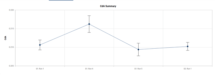

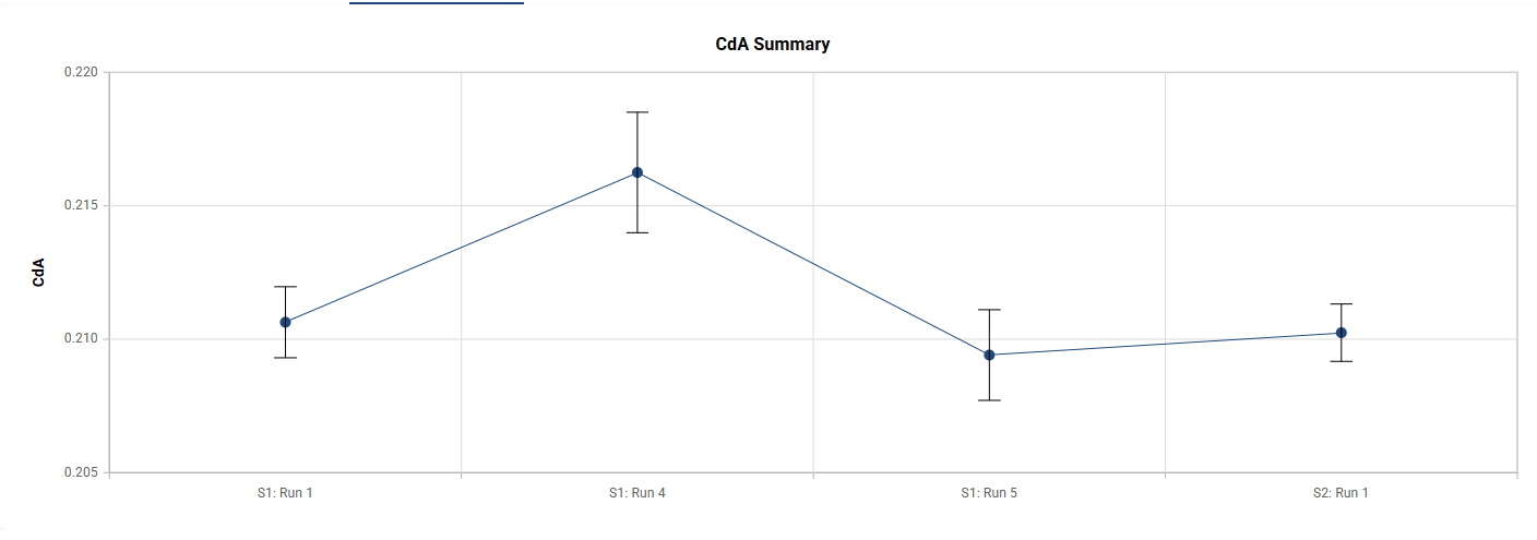

I’ve done some testing with the WD and Aerohead. The first two runs are with the Aerohead, it shows a bit of spread between the two tests. Most likely because I put it on my head slightly differently. The right two tests are the WD, so quite close together. These tests were all performed on one morning, I started with the WD, then the AH. After that I did quite some other tests and went back to the AH and WD to verify my baseline.
Concering comfort, the WD is much more roomy and significantly cooler. The only downside is that I haven’t figured out where to store the visor during a ride. Especially for a course like Nice, this is important (i.e. climbing at 10-15 km/h).
