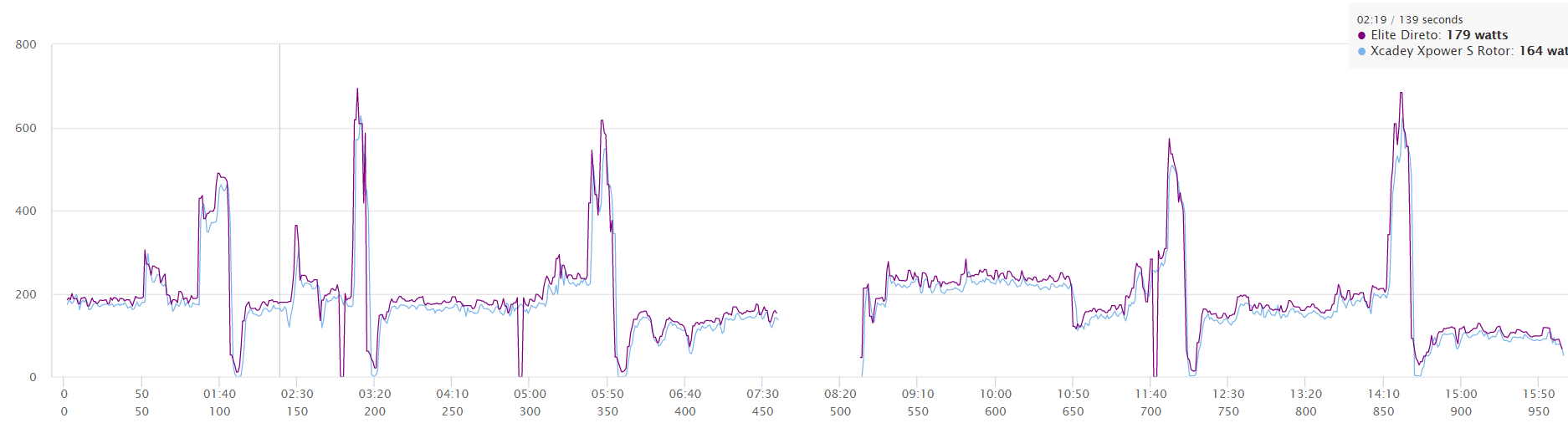

tested my Xcadey against my Elite Direto today. I am getting similar results to GPLama in the XCADEY is consistently under reporting power by approximately 4-5%. given that this is comparing spider versus hub based power then tthe difference goes up to close to 6-7% given drivetrain losses.

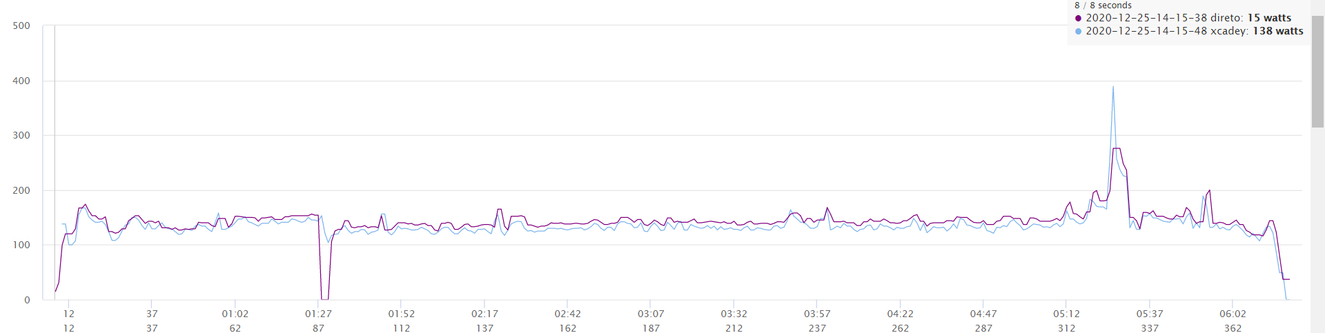

Update:
Xcadey Xpower S under reads by about 6-7% versus an elite Direto (see attached file) . can hopefully be remedied via power scaling in their app.

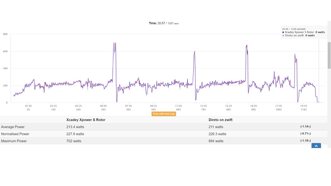

Update: Xcadey Xpower S looking very good after latest firmware update and scaled up to 110%. near perfect.
