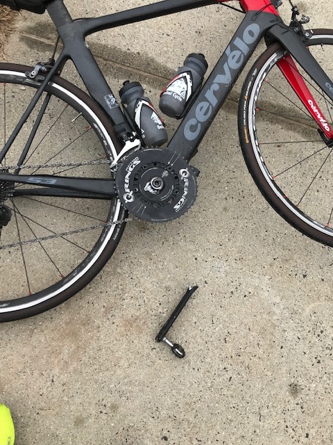

Curious if others have had problems with Rotor cranks. I have a Cervello S3 that came with Rotor cranks. In 2016 I snapped one crank where the pedal arm attaches to the bottom bracket. I chalked it up to a defect, and Rotor was great about paying hospital bills, sending new equipment, and paying labor to have it installed. Yesterday, I broke the pedal crank again, this time on the chain ring side where it attached to the big ring. See photo.
Has anyone had this type of issue with Rotor. I am not big powerful guy, I am 160 pounds with a 270 watt FTP, I can’t imagine why I would be snapping these cranks but others are not. Thanks for any input.

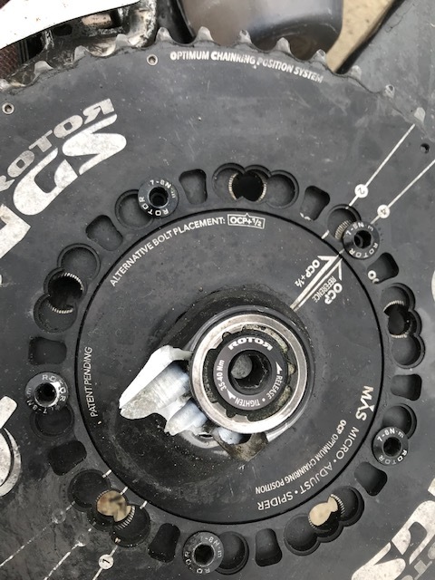

From the fracture surface shown in the second picture, it looks like a fatigue failure. It also looks like the crack has been growing for a long time.
Thanks for the input. I have a couple of manufacturing engineering friends that came to the same conclusion. Now I have to figure out how it got cracked / fatigued in the first place.

It looks like the lock ring bolt is on the outside in the 2nd photo. The 8mm bolt should be on the outside when the crank is installed. You would flip it to the way picture only for crank removal.
I could be wrong, but double check that.
I’ll have to have my bike shop check that, I am clueless regarding your question.

Is that a 3D30 (3D+) crankset?
Looks exactly like that to me, i.e. in the remove crank position. Here are some shots of my 3d+ with the ring in both positions:

He has the newer one piece extractor bolt not the two piece
Type of crank it is will tell the story here. Based off the bolt style, I am thinking that is not a traditional 3d+ and is instead an inPower unit? Not thinking it is a 3D as those guys attach from the other side. Anyhow, disregard my previous post if this is not a 3D+, which I am leaning to it not being.
Ah, gotcha. I thought that might be inPower specific, but I guess it’s a smart move to switch them all over. Like that style much better.

I have 3 Rotor 3D cranks with 24mm axles. I haven’t had any problems at all with them. But, in looking at your broken crank arm, I wanted to just add in my .02 cents worth of thoughts…
To me (and no, I am not an ME), it looks like a stress fracture based on an inward lateral force. By this I mean (let me see if I can explain this in words well enough…), that the break looks like if the crank arm was in the 6 o’clock position, and you applied force laterally inwardly to the arm towards the BB bearing, that it then cracked off. Essentially, say when you’re standing and rocking the bike left-right-left-right (as in climbing), that when on a down stroke at the 6 o’clock position as the bike is leaning over and your leg is pushing straight down, that’s when the crack happened???
Maybe someone with an ME degree can properly explain what I’m thinking may have caused the break?? But, it still does not explain or excuse the break itself. Maybe just a bad batch of trinity drilling that got too close to tolerances???
Again, I am not throwing blame anywhere, rather just thinking about what forces may have caused such a break.
