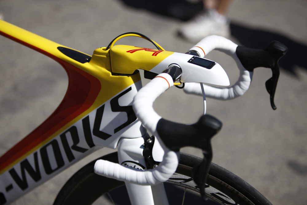

Okay, I know this is pretty antithetical, but hear me out. Has anyone ever used a road bar (with road brake/shifters) as the base bar on a TT bike? Aero extensions as usual.
It seems to me that being in the drops on a road bar is actually a bit faster than holding the hoods on a standard TT base bar. So anytime you’re out of the aero position on this frankenbike, you’d actually be faster than out of aero on a normal TT bike. In the aero position the road bar would be slower, but how much? I don’t think we’re talking 5 minutes over 180km here.
I’m not a very confident descender; I’m much better and faster in the drops on my road bike than on the hoods on the TT bike. And on a rough curvy descent I rarely hold aero for very long. And I’ve never been a fan of tiny little TT brake levers. I’m thinking that having road bars would potentially make a bike faster FOR ME, since confidence breeds speed in many cases.
Has anyone ever thought about or tried this?
Like this …
https://www.neilbrowne.com/2012/01/the-2014-shiv-road-bike/
https://www.neilbrowne.com/2012/01/shiv-road-bike-project-part-ii/

Oh hell yes. Thanks for the gallery, that’s exactly what I was thinking about. I know it will technically be aerodynamically slower, but like I said, it may well be faster FOR ME.
To bad it’s fairly time consuming/expensive to test out, but it may well be worth an experiment.

Because of a broken shoulder, I can not stay in the aero position very long, but I can stay in the drops without much discomfort.
I put the road bar on a Speed Concept and then added DI2 which gave me shifters on the aero extensions and the drops. I really like being able to shift from the drops. Shifting is a lot easier when on the hoods.

I have used various drop bars. But, currently, I am building up a n.P3 with an AL bontrager aero drop bar that I was able to find for 50 bucks.

I have one on my Shiv. There is an aero penalty but it’s not huge. I’d guess about 3 watts slower than something like an Alpha X. That’s significantly less than road drops + hoods. IMO the Revo is every bit as secure as being in drops.
