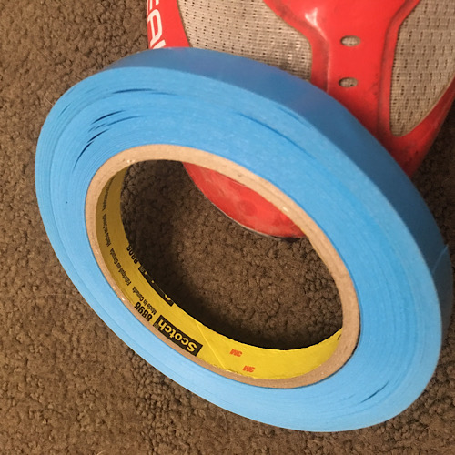

Rim tape, perfect for latex tubes and tubeless

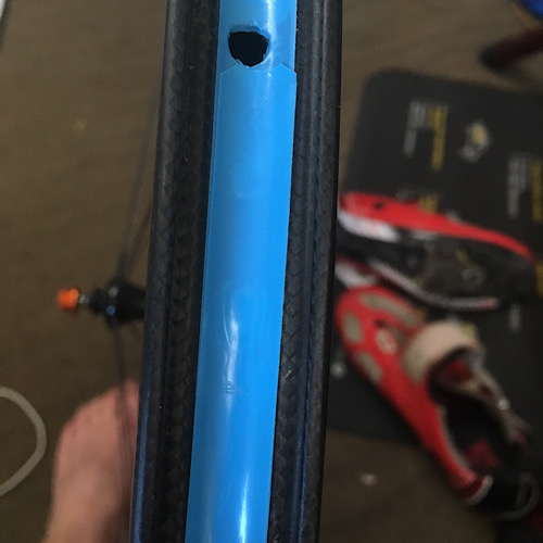

Scotch (3M) 8896 strapping tape, 12 mm wide x 55 meters. One roll is enough for 12 wheels, double wrapped. 12 mm is perfect to seal the full bed without causing interference for mounting tires- see attached picture.
8896 is the same tape as 8898 with an improved adhesive which leaves no residue when you remove, meaning no clean up mess!

I have not tried this with tubeless, so do not have personal experience, but there are a lot of reviews on using 8898 and 8896 as a tubeless rim tape, and all of them are very positive. The 8896 is the same tape as 8898 with a better adhesive. Better because it is equal in adhesion, but leaves no residue when removed. (It is a bit more expensive). I cannot tell the difference between this, and what Princeton Carbon Works supplied with my wheels for a tubeless set up- except it is a lot less expensive :slight_smile:
One important note- you get your best result with 2 wraps, and press out any bubbles with your thumb as you apply. I initially used 24mm, but that comes all the way up and slightly under the rim bead, which makes mounting and removing tires a bit tougher. I love the 12mm, it has been perfect.
