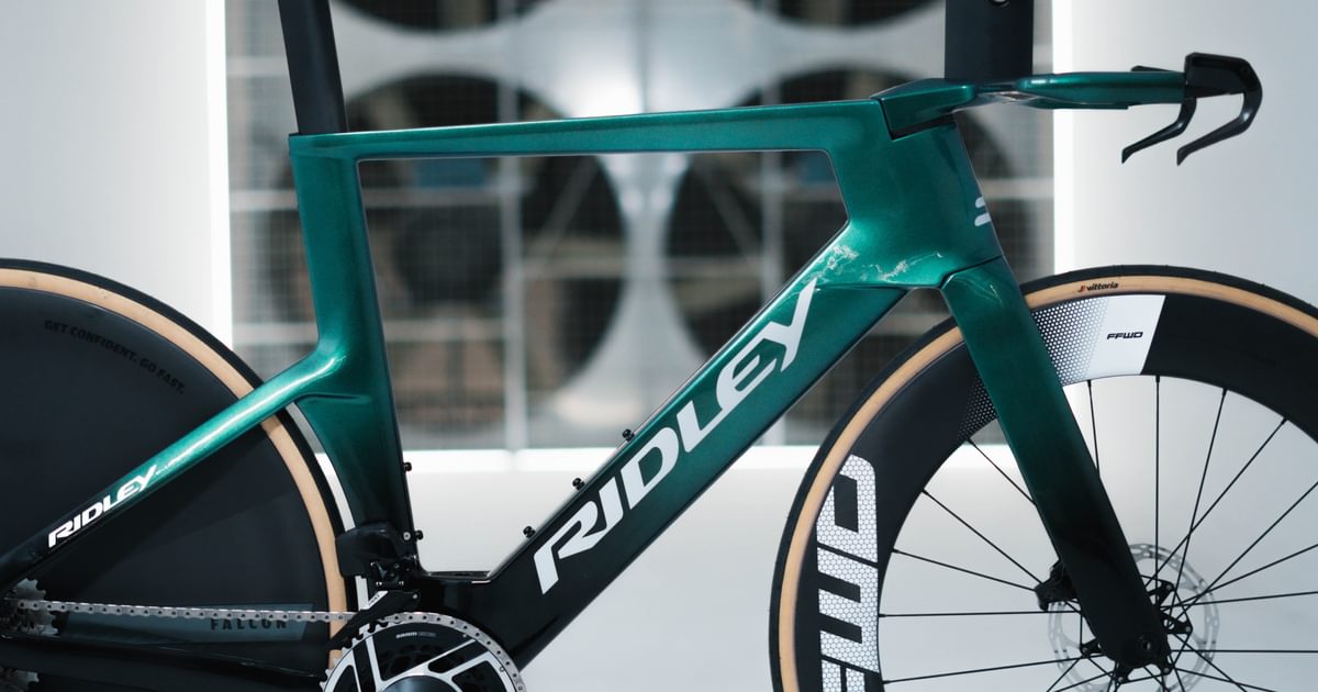

New bike coming from Ridley. Most likely with a frame bottle like BMC Speedmachine as they speak of integrated hydration and they talk about storage boxes to add on.
Seat angle looks pretty steep, but Deda cockpit would not be my choice as an OEM stock in selling a bike like this. It looks skinny in the tubes so probably UCI legal as well to serve also as their TT bike.
Looks lightweight, skinny, simple. I like it. Primarily a TT bike.
Looking at it I had the same reaction
But then I read this
“We will launch the Triton Fast in 2025: an aerodynamic racing machine tailored to every triathlete. Thanks to the modular design, you can adjust the Triton Fast to different triathlon formats. Furthermore, a longer seat tube ensures a more comfortable position, which you can adjust even more finely via the flip chips. Thanks to the internal drink guide and the strategic frame packs, you are completely ready to achieve the most efficient performance!”
I wonder what “longer seat tubes” do :slight_smile:
I had the same reaction. What in hell would a longer seat tube do for extra comfort. My good guess is that they meant a longer top tube and increased reach.
Although it would also be a stupid error :-).
I think this is the bike Nick from Wove recently mentioned. So I am very curious to the add ons and flip chips :-).

I think they meant the dropped seat stay and therefore exposed longer seat tube above the rear triangle.
Anyway… interesting then that they target it first at tri, although it does look like TT.
I’ll be eager to see the geometry chart. Could probably take a TriRig cockpit as well if they’re selling frames only.
It being a TT bike doesn’t bother me too much since hydration is so easy to do BTA and BTS now anyways.
The geometry is spot on. Best ever imo.
82deg sta in Medium+ frames, 80deg for XS and Small. Frame reach 4-6cm longer than other brands, which will allow for the stock risers to be used with no reach extension plates or after market risers.
and with so many people replacing stock aerobars, it’s nice to see they aren’t investing in proprietary bars
It’s telling that they have the seat slammed forward on the photos, perhaps.
it’s a photoshoot, not a bike fit, so I don’t think there’s much to glean from the photo.
I don’t remember if it was you or @marcag talking about a forthcoming bike with more reach than you’d seen on any other modern bike. Is this that one?
Can it be that with “zitbuis/seat tube” they mean that it has an extra long saddle clamp area, and they aren’t referring to the real seat tube?
In that case the extra comfort comes from being able to have a wide range of seat angle options which results in more “comfort” when you get it right for your individual needs. And those flip chips might be inside the adjustable seat clamp. Just an idea.

As you have the geo chart do you mean longer armpad reach or actual longer frame reach?
The frame doesn’t really appear to be thát much longer by looking at it.
Jeroen
Frame reach 4-6cm longer. The stem/basebar is a cm shorter than most bars, so stock pad reach ends up being 3-5cm longer overall for sizes XS - XL. In addition, pad reach adjustability is larger than most other brands. This is a big win imo
Being named the “Tri” ton, it seems tri focused. the geometry sure looks that way, and it’s appreciated.
Interesting as it looks like their TT dedicated bike as well and I wonder how they can fit still within the uci rules with a frame that is that much longer in frame reach. I think FC can still not exceed 650 and wheelbase 185 cm, but maybe I’m overlooking something.
Jeroen

I made some geo drawings at home being sick as a dog and it still could fit in the uci box of dimensions with those extra long reach in top tube / seat angle.
