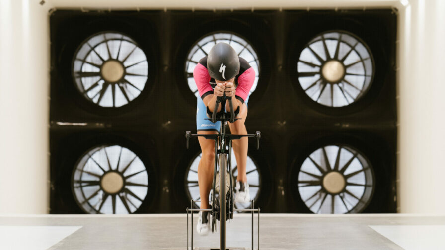

The basebar on the Shiv Disc has a similar bulge (for folding during travel). Wonder if it serves a similar purpose aerodynamically.

In all honesty, I think this bar is a piece of marketing hype. Even in the article you can see the CFD where the bars only create a few inches of turbulence behind them. Your knees at the middle of the downstroke is probably 4-5 widths of the bar behind the bar and even more at the middle of the upstroke.
Same principle as drafting, I could draft a rider 3”away and travel at 30mph for 200w move a few feet back and you start increasing resistance. Move several bike lengths back and the draft is only a few watts.
I really like the ITU bars though. I have a 3T Zefiro bar. Comes with a ITU bar standard but I also have a set of ski bend extensions and pads for hilly triathlons.
Aerodynamics is hard. Real world, air is never laminar. Wind gusts, changes direction, affected by cars, trees, bushes, hills. No one actually rides in a CFD simulation(maybe if you have a Tron bike) or a wind tunnel.
