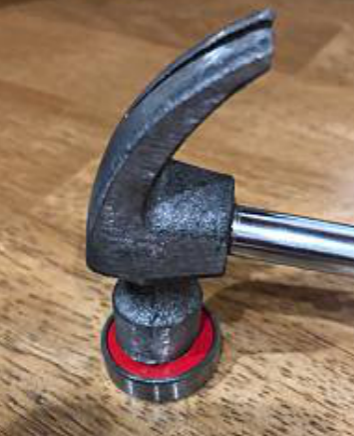

I am not surprised they want you to spend more money lol. But Hey! If the tool is affordable and makes bearing replacement easy then it is worth it. I won’t tell you what the cheapo hammer cost that I used to tap out my bearings, but I will say that it was bought at a dollar store. As long as they come out and go in straight, I don’t think there is going to be large enough internal scratches for concern. This is the 2nd time I’ve changed mine and those buggers still require a more than a love tap.
I will say this though, when removing the first bearing I used something similar as a flathead screwdriver to tap around it in circles so it would come out as straight as possible. For removal of the 2nd, I stuck something larger through the hub that would apply pressure fully around the bearings so it would come out more easily. Installation of both was a lot more easy since I could use something larger to knock them in.

Getting them out is easy, tap the axle.
Getting them in requires you to press the last bearing into the hub while sliding along the axle, hence the need for an over axle press system.
You cannot use the old bearing to press with as it will stick on both the axle and the hub cavity and you cannot get it off.
You have to have a dolly just oversize for the axle and just under size for hubshell so you can press the bearing in and then remove the dolly.
You cannot fit these with a hammer, so stop bullshitting, the bearing seats under flush.
You cannot remove the first bearing with a screwdriver as it has a shoulder on the inside edge of both bearings so they have to come outwards whilst the axle is in place, so tapping it out with a soft face hammer is the only way to remove the first bearing, you can bash out the other in any way you wish, but simply putting the axle back in and tapping works best and will be what is recommended by the manufacturer.

Over axle press.
An over axle bearing press isn’t proprietary.

Here is the hammer and 1 of the old bearings for a size reference showing that it is possible to use a small hammer without damaging the hub shell.
