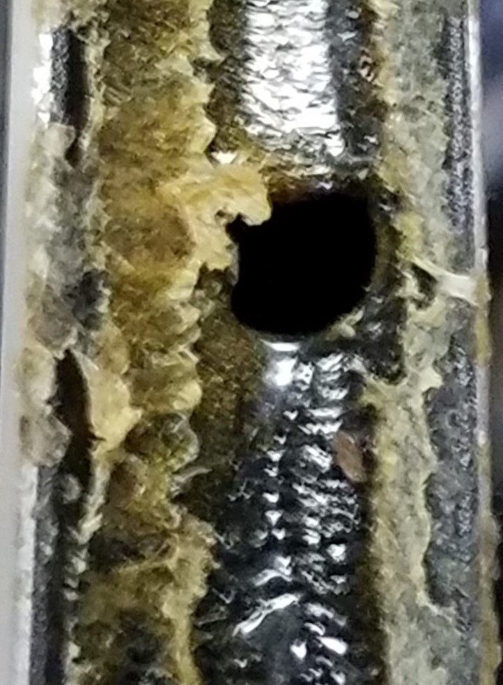

Thanks for this, I am looking at removing tubular glue from my cyclocross wheels this weekend. After a quick YouTube search, I found this video from Zipp: https://www.youtube.com/watch?v=LY7polDoW1c
The video recommends either Acetone or Goof Off, otherwise the warranty will be voided. If it’s good enough for Zipp to reccomend, I think I can trust it :slight_smile:
See picture attached if curious. Here’s hoping I can get away without spending too much time on it!
unless it’s really nasty or you ripped off the previous tyre and left a bunch of the base on the rim, I’d just glue over it. Usually you get a better adhesion than on a “clean” rim anyways.
