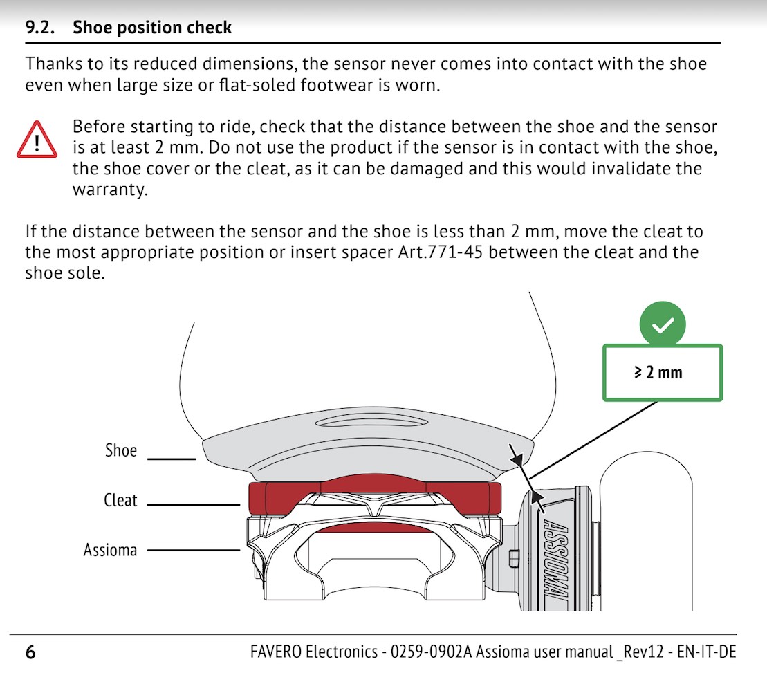

Here’s the potential issue. If it were me, I just put the cost of the adapter towards a new pair of clipless shoes.
Agreed, hence my “if”. But $10 on a plastic platform is a lot cheaper than a new pair of shoes every year for a growing kid…
