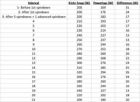

Been using a Kickr Snap for the past 2.5 years but ever since the last firmware upgrade the power has been way off compared to both my powertap and power2max. I reached out to Wahoo but got no support besides initially suggesting my problems were user error and upon providing more data, the response that it’s properly calibrated.
I did a test riding at the same speed, same gear, and increasing power in steps of 10W in 3 minute intervals, and comparing the average values between Kickr and Powertap. See results below - the data starts after a 10 minute warmup period was already done.
Per Wahoo, the kickr is properly calibrated which I guess means in their opinion ‘good enough’. For me, this is not good enough; when using for example Zwift it will overestimate my power significantly making it too inaccurate. Plus (and even more importantly) when I just want to do a workout in erg mode, I need to take wild guesses to hope to end up with a power where I want it to be. The higher the power, the more the Snap is off, hence training FTP or VO2 max level becomes very difficult. So, are there any suggestions or tricks I can do to maximize the functionality of my Snap? I still need a trainer that I can rely on and if I can’t do it the way it’s intended, what can I do to improve the functionality? And secondly - is the level of inaccuracy something that is acceptable, or should be expected? Part of my issue is that I had much higher accuracy up until the latest firmware upgrade.
Note that Wahoo ‘offered’ for me to send it back at my cost, so they could look at it and return it (at my cost) but given the fact that their response already was that the Snap is properly calibrated I don’t expect I will actually be helped much.

Mine is similar to yours. Between 200 and 300 watts, it consistently reads 20 watts higher than the powertap. There is also a bit of drift, presumably from the tire warming up. So by the end of a 60 minute session, the difference gets closer to 30 watts. I’ve just learned to ignore the Wahoo and focus on the powertap, ratcheting up the resistance as necessary.
The Kickr Snap has a 5% accuracy from what I remember. Was the Powertap the P1 pedals, or the hub?
Could you amend your spreadsheet with the % error in each case?

Your data looks like what I would expect if you were having an issue with tire slippage/not clamping the tire down hard enough. Put on a new tire and see what happens.
Before the system and tire are warmed up you are off by about 18%. As the system comes to temperature you hit the 5% difference expected for a Kickr. The change is consistent with expansion of the tire as it heats up. Wheel-on trainers generate a lot of heat at the tire/resistance wheel contact which gets transferred into the tube causing air expansion and a better contact with the trainer.
However the same process eventually heats up tires to a point they begin to deform and slip at a higher rate. Your data shows a gradual increase in the offset between the power meter and your trainer from 5% to about 8% after your first 250 watt interval. I would guess your tire is shot and that Wahoo are correct in stating you trainer is working properly. It is possible the firmware update altered the way the trainer reports peak power pulses associated with tire slippage, but it may be a total red hearing.
The tire has been clamped down at 2.5 full turns and with a spindown comes to a stop in around 13.7 seconds. It should be under 15 per Wahoo. Note that after I started recording the data from the table I already rode on the trainer for 10 minutes, again per Wahoo instructions. The first numbers are before doing a first spindown and then after an advanced spindown and then a simple ladder. I doubt your reasoning about tire warming up first not enough, then too much - because my ladder going UP and DOWN give the same average values at a given setting. For example at 220, 240, 260W… the first interval at that (kickr) power resulted in the same powertap power as the second time I rode at that (kickr) power, meaning that the riding in between did not effect that value. If nothing caused a change in powertap measured power there isn’t a mechanism happening that is changing power transfer - like tires heating up / expanding / etc.
Plus, my tire isn’t ‘shot’ at the end of a training to then miraculously ‘heal’ again when I take it out on the road and when it still has substantial life left per the wear indicators. And I get the same thing with 3 different wheels with 3 different tires…
