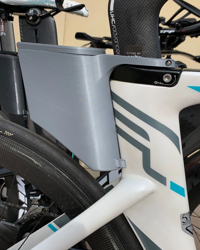

A while back, a bunch of you saw my rear storage box for the Cervelo P5 and asked that I make one for the Felt IA and DA. Well, after extensive design and fitting sessions on some volunteers’ bikes, the boxes are now available for sale at http://www.custombikexcessories.com
Below are my boxes on a Cervelo P5 56cm, Felt IA 54cm, Felt IA 48cm and Felt DA 51cm. The box for the IA will fit on 48cm and up. The one for the DA which will fit on 51cm and up.
**NOTE that the boxes are not the production versions. They will be matte black with a texture that feels like 1200 grit wet dry sandpaper. **

Close up of the box on the Felt IA.

They look great. Congratulations.
But how do they ride??? Be great to get some user feedback from testing the prototypes. Is there any movement or vibration in the box when going over bumps. The lack of a fixing at the base of the box looks like a potential rattle source. We all hate rattles.

It’s a similar design to the box I have on the P5 which does not rattle despite the one fixed point around the seat post. Note that on the Felt, I added stabilizers at the bottom to keep the box from moving side to side. a small piece of electrical tape where the stabilizers are will make them snug. Also the arc at the top of the box where the clamp and box meet keeps it quite stiff.
Admittedly no one has ridden the bike with the box yet. But I stand behind my product, the design is proven on the P5 and will actually be better on the Felt because of the arc and the stabilizers.

Nice! If it rattles, could probably superglue some innertube to the part that touches the seat tube to silence it.
A small piece of electrical tape on the frame where the stabilizers are, will do wonders.

I see that on the P5 you have different sizes, but on the IA it is one size fits all. Any reason for that? I worry that on my 58cm frame it may look a bit small.
Good catch, the reason is that on the P5, because of the sideways V on the rear of the frame, it would look really bad if I didn’t have the box go all the way down to the tire and not match the curve of the frame.
On the bikes a with straight seat tube like the IA, DA, Parlee TTiR, that is not an issue. I would have liked to make the box go all the way down and just have 3-5 mm clearance between tire and bottom of the box, which aesthetically would look much better and REALLY COOL, but that presents it’s own set of problems:
this makes the box deeper, which means that any small item in the box that ends up in the bottom cannot be reached with your fingers, the only way to get anything out of there is to flip the bike upside down and end up with all the contents of the box spread all over the road. As it’s designed now, I can just reach the bottom of the box with the tip of my fingers and grab whatever is down there, like the valve core removal tool. The bigger the box gets, the more expensive it becomes to 3d print, it’s substantial increase.The 3d printers have a limited size that they can print. With the 58 box for the p5, I’m close to that limit.
If you like, you can email me at yann@custombikexcessories.com and I can email you a pdf of the outline of the box to print out and cut and place on the bike so you can get a sense of scale on your frame.

Are you willing to share info on your printing? Printer, material, wall thickness, fill density, etc?
How is the lid attached? Does it seal well?
By the way, at the lower alignment tabs, I’d be using double-sided tape to help keep it in place.
For surface finish, maybe try an acetone dip after sanding (dip for a few seconds then air dry). Adds an excellent gloss to FDM prints.
No, no wind tunnel data, box was born out of necessity. I hate the saddle bag on my TT and it got in the way when I had to put a behind the seat water bottle cage. I had no choice but to design a box for my stuff.
As for settings, I am using a Prusa MK3 printer using the prusa version of Slic3r printed in PLA. Wall thickness on the box is 1.25 mm. Fill density 20%
Lid is attached via 4 magnets, 2 in the top, 2 in the bottom, and a short leash to keep from losing the lid.
