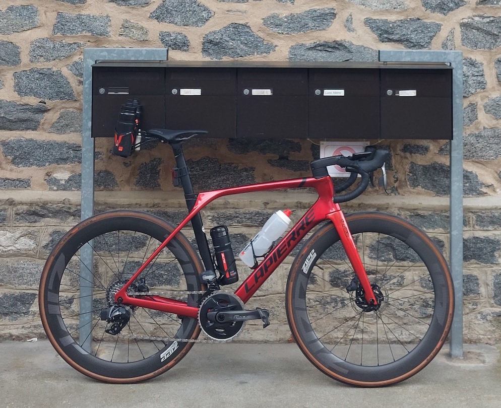

Hello folks, been a reader of this forum for long time and 8 months ago I decided to embark into my IM journey!
I’m going for IM Nice this June (ofc not the WC) and I’m trying to figure out an ideal bike setup (I have a normal aero bike) to carry as much nutrition and liquids as possible.
I realized I need to carry at least 3 bottles (1 with liquid nutrition, probably 950ml with 6 maurten 320) and the others with water (maybe 1 water, 1 energy drink) to refuel at each station.
I bought an Elite SkeKane rear cage system that allows me to carry 2 additional water bottles and it seems to be compatible with carbon rails saddle; my carbon rails saddle (Selle Italia SLR Carbon) is ofc not made for such a setup, so it’s impossible to find if this will lead to cracks.
I installed everything, torqued to 3nm and the setup is super stable (tried going on bumpy roads) even when I fully load it with to full 750ml bottles and 2x60gCO2. Before attaching the saddle to the rails, I did cover the rails with electrical tape just to prevent accidental scratches (although the attachment mechanism on the SkeKane has some padding.
Attaching a few photos.
Any experience with similar setup? Something I should be worried about?

Given my first IM will be Nice and the course is hilly I decided to stick to the bike I had and make only minor modifications (see picture).

-Saddle rails are designed to be clamped and bear high loads/torque from your body weight. Two bottles is very little in comparison.
-Lots of riders use double carriers with carbon-railed saddles, and you don’t hear lots of stories about failures.
