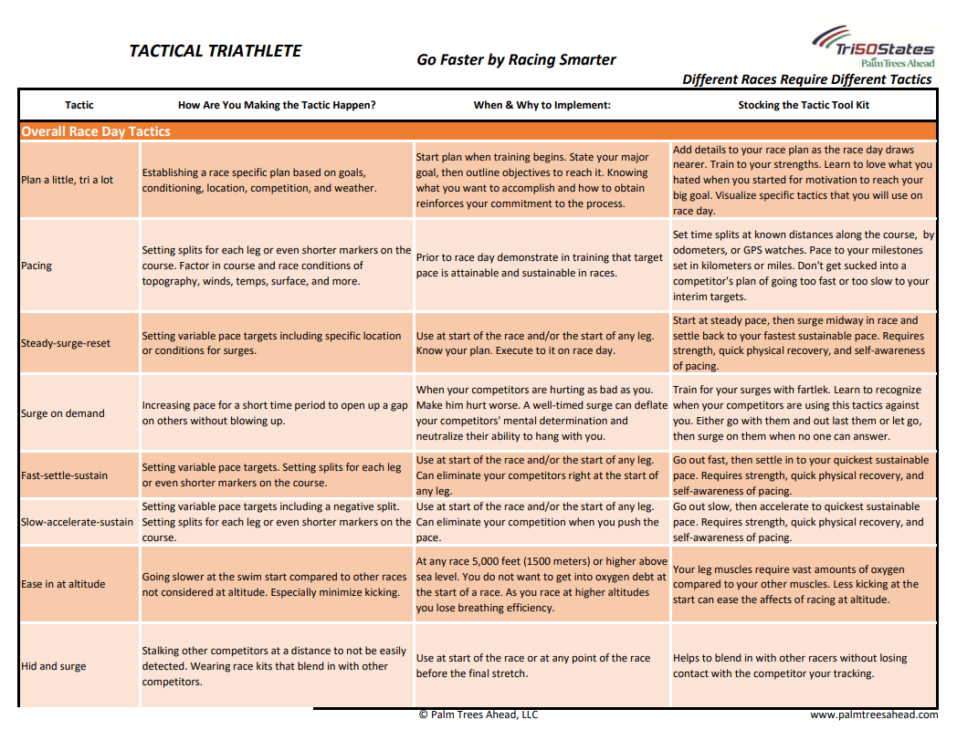

Here’s some general racing tactics. You can find plenty more within Slowtwitch postings on the specific topics, talking with clubmates or other triathletes, and looking elsewhere on what you want to learn more about.
https://www.palmtreesahead.com/
https://www.palmtreesahead.com/tactics2faster-new

thanks, that spreadsheet is pretty cool.
