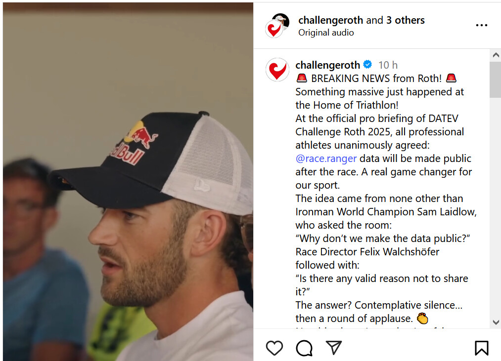

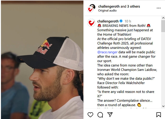

Bit of movement/development here!!
Firstly in the Pro Athetes’ Brief, Challenge Roth offered to share the Race Ranger data post race.

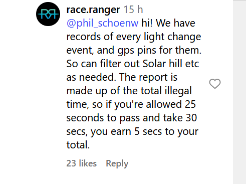

As you say. See RR’s comment on the post below:
So are we giving grace if a pro has 48s of “illegal time” over 112mi? What is the “threshold” going to be from a “discretionary” standpoint? Under 2 mins of illegal time over a IM distance is “fair”/understandable? No one sits there and counts 1.2.3.4.5 when they are passing, so if it’s 27 instead of 25 is that that big of a deal? But obviously 50s instead of 25 would be, etc.
(and again we are talking about data that basically only in “reviewable” form, not as a specific race violation tool as of yet…I think we will eventually get to the point that we scrub data while they are running and give penalties on the run for being too much in the illegal time zone…which would be a 1st…currently your only in trouble with drafting if you get caught by the official. This essentially can correct that)
“We” are giving nothing. If a pass takes >25 secs, the drafting seconds will record. If a rider goes inside the draft zone and then drops back, that will record (the number of seconds). If they do that behind the same rider more than once, sequentially, that will allow inference. If a rider who’s passed doesn’t drop back in the time allowed (MD/LD = 25 seconds), every second over will be recorded.
