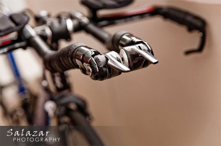

Now, these are the benefits that SRAM and Zipp are already advertising, but once you have actually tried the shifters out, you get a feel for how big a difference it actually is. I’m definitely not going back to traditional bar-end shifters ever again. They just feel right. Others have talked about the levers being a bit stiff, or difficult to shift. When I first pulled them out of the box, before mounting them, they felt a bit that way. So I applied some WD40 to the main shift index rachet. You can access this ratchet by unscrewing the 4mm hex bolt (the one you have to unscrew anyway when you install the shifters). On their first couple rides, the shifters loosened up quite nicely, and I can now shift using just a thumb or index finger.

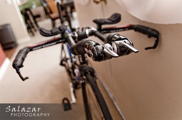

I mounted them using some customized JagWire BarCon 2.0 mounts. Note that the Jagwire units will NOT work out of the box, and will damage the R2C if you try to mount them up. I had to do quite a bit of machining to get them to fit. The problem is that they’re designed for the regular TT shifters, which have a smaller diameter body. I also sanded off the logos, and re-applied clear coat. I generally don’t like logos, especially on the one component I’m going to be looking at all the time. I’d rather just see the lovely glint of the unidirectional carbon fiber.

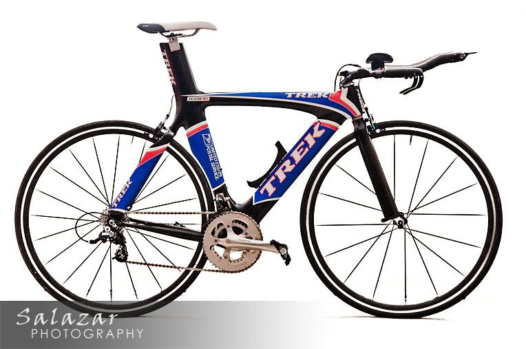

Here they are aboard my 2001 Trek TTT (kept the logos; this bike is a piece of history), and a set of Felt Bayonet handlebars (haven’t had time to remove logos yet). The F-Bends are awesome, by the way.

Anyway, back to the R2C. I did think that it would be helpful to be able to see my gearing from the aero position, but honestly, the little hash marks are too small for me to be able to distinguish quickly at a glance. It’s quicker to look back at my cassette or chainrings.
