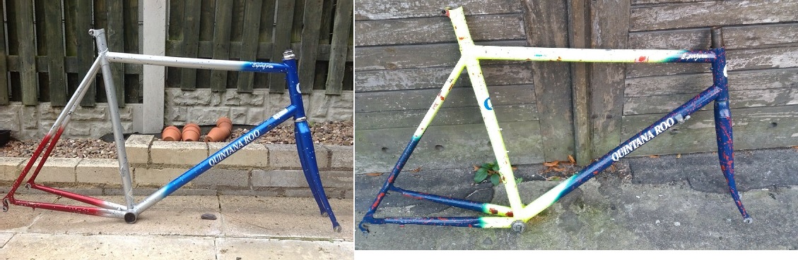

Hi all! I have some questions about the geometry of these two oldies: they seem both “largish” sizes, but there are quite a few differences between the two
“grey one”: top tube 56cm, seat tube 51.5cm, tange prestige ultralight sticker, chain-stay bridge, vertical dropouts
“yellow one”: top tube 57cm, seat tube 48.5cm, no tubing sticker, no chain-stay bridge, horizontal dropouts
anyone knows or can explain the reason for such differences?
I know superforms weren’t produced for long (possibly 1989 - 1994); these are possibly both “later” models, being the rear brake cable internally routed (it used to be external on earlier ones)
Thanks!
Thanks!

i do not recall any difference in geometry between superforms, earlier versus later. we moved from the superform to the zero gravity pretty quickly i think. the superform was, i don’t know, maybe 89 to 91? but karen has a much better memory than i do for that.
the biggest differences in geometry, over the first few years, had to do with adaptations to other products:
  1. bars like syntace had a large gap between the pursuit bar center and the top of the pad (7cm), versus the original scott bars (more like 2cm), so we had to lower the front end to make room for the bars.
  2. our seat angles went from 80° to 78° to accommodate the zero offset seat posts that were becoming popular, and which we used on our bikes.
we also dropped the top tube level with the ground, and that meant that the seat mast was sticking up. we eventually just stopped the seat mast at the top tube level, because we couldn’t trust that people would push the seat post down past the top tube / seat stay junction.
as rear ends got wider (126.5mm to 130mm) i think we lengthened the chain stay a bit so that we didn’t have really bent chain lines.
our first superforms were pretty long. long cockpits. we would have shortened the cockpits, but i think the syntace bar pretty much solved that for us, because that bar had the pads set back a bit behind the centerline of the pursuit bar.
that’s all i can really tell you. that exhausts my memory unless somebody comes up with some data point that jogs it.

we can then say that the yellow/blue frame is a “syntace superform” (besides, it spots a “syntace” sticker on the left seatstay), while the red/blue/gray one is a “scott superform”.
I had built the yellow one in “neo retro” style (ultegra 10s parts, semi aero vision wheels, modern saddle and seatpost, profile cockpit with headset adapter etc.); it fits ok, but yet I wonder how the other version would fit and ride , with different stack/reach ratio.
Possibly the differences with tubings, dropouts etc. depend on supply reasons
