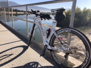

Great bike. I don’t use the water reservoir in the downtube because I prefer to drink water from a bottle rather than sip from a rubber hose. But I’ve got mounts for two bottles, one between the aero bars and one on the down tube. I run 23 or 25mm tires on the Zipp wheels. What I like about the bike is that it is solid, uses standard components (I have Dura-Ace gruppo with shifters on the aero bar ends) and it’s silent when pedaling. I bought mine used from a one-and-done athlete, so I got a great deal on it. Highly recommend this bike.
Deleted - mine is Shiv Tri as well.
Looks like you have Specialized Shiv Tri, not the Shiv TT.
