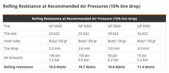

From BRR: https://www.bicyclerollingresistance.com/specials/grand-prix-5000-comparison
Wider tires do not have lower rolling resistance at proper inflation pressures.
Using the same drop percentage for two tires of differing width for the same use case does not make much sense. It means you’re inflating the wider tire much squishier.
The old 15% rule of thumb was intended to adjust the tire setup for different use cases. A 50mm tire gets inflated much squishier than a 25mm tire because it’s assumed that the 50mm tire is being used in rougher riding. But if you’re using the 50mm tire on a smooth road ride, that assumption is false.
Even BRR’s later test using absolute drop distance doesn’t make much sense to me, since a tire’s spring rate with respect to a flat surface is different than with respect to road irregularities. In particular, if the dynamic situation tracks the static one, this study appears to imply that the wider tires were still being inflated to greater compliance.
It seems to me that the way to answer the question usefully would be measure and characterize how breakpoint pressure changes with tire width, and compare crrs at those pressures. This makes the question more complex, but it’s unclear to me that the proxy methods being used by BRR are actually answering it at all.
