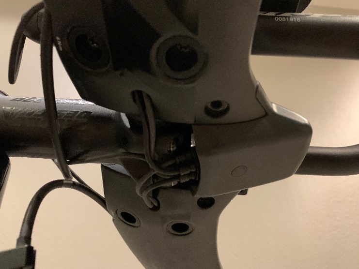

For reference, here are pictures with DI2. Profile Design 17 degree stem. and how it looks on a bike (don’t think i have the picture level, but I am not good with my phone, and it seems good enough)
Thank you.
