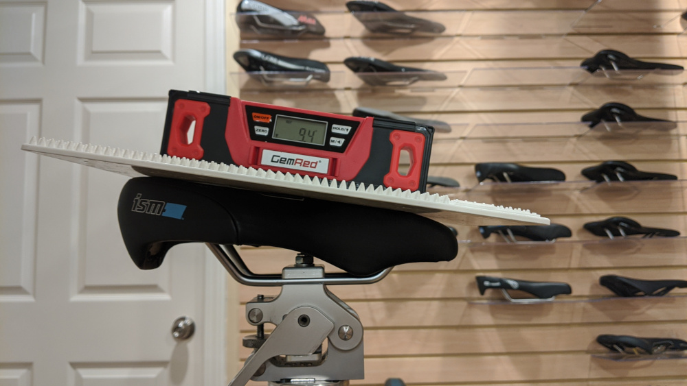

I find that a lot of customers prefer the PR saddles with the rails slightly up. As you have experienced, there is a feeling of sliding down and instability that occurs with the rails level. It’s maybe just a bit too much for a lot of folks.

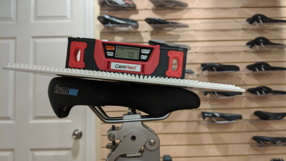

In this first picture, this is the PR 2.0 with the rails level (which I usually just eyeball using the slatwall in the background), and that is at -9.4 degrees. I’m kind of going by memory, but if I were to state an average, a lot of people seem to like something in the -6.0 to -7.5 degree range. That looks more like this:
That’s not quite as flat as yours, although getting closer.
The key with this is that it’s going to be a combination of what feels right and your position, as far as handlebar/pad height relative to saddle height. My belief is that you can’t fire a cannon from a canoe - you need the saddle to provide a stable, yet comfortable place to support your pelvis. If you are tilted down too much, you’ll be sliding down due to gravity which is both unstable and less efficient, because your legs are now supporting your upper body weight. Don’t waste your energy holding yourself up on the bike - save those glycogen stores for your big muscles in your legs. On the other end of the saddle angle spectrum, if you tilt the nose up too much, you’ll start to stress the spine. I find most people seem to need to be in about a half degree sweet spot for a given saddle for that person. Two or three tenths of a degree can make a big difference.
So, for the short answer: there’s nothing wrong with your saddle position if it feels good while you ride, you’re not scooting yourself back all the time, and your back is good after your ride.

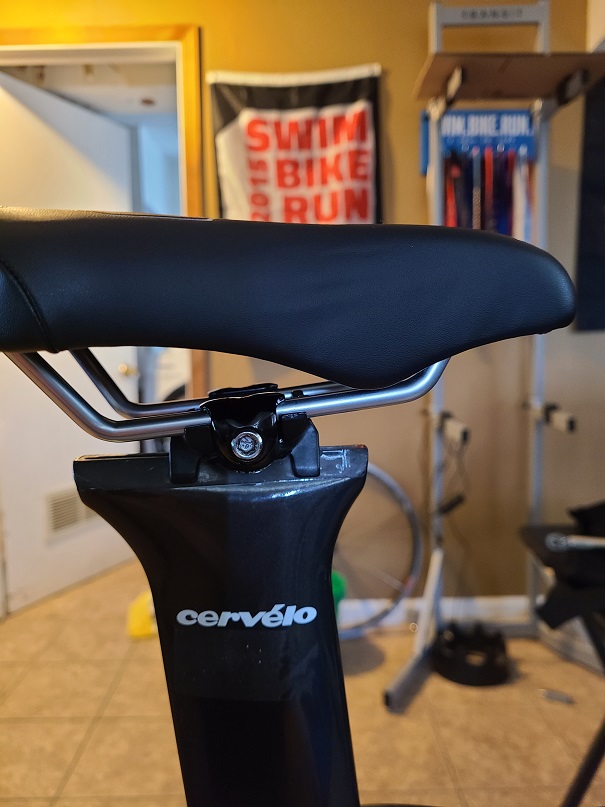

I’m not a fitter, but this is my bike with a PR2.0 on it. I’m very comfortable. This is a zoom of a photo taken on level ground:
https://i.imgur.com/5uYOKTh.png
Regarding how I sit on the saddle, the frank and beans are forward of the saddle nose.
I suspect that might be relevant to the discussion; it’s the same for me. The goods are basically hanging off the front of the saddle, unsupported. When I look at the part of the saddle I actually sit on in the above photo, it’s more or less level.

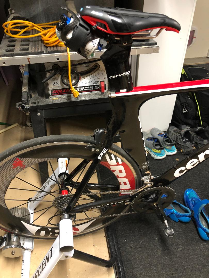

I ride a P2 with a ISM saddle, the rails are level.
My bike fitter commented that I tend to slide forward on this setup.
He advised sanding the saddle to “roughen it up” and stop the sliding.
I’ve experimenting with bathtub nonskid tape (too rough on my shorts) and thin strips of neoprene (much better).
Apologies for the workshop photo!
