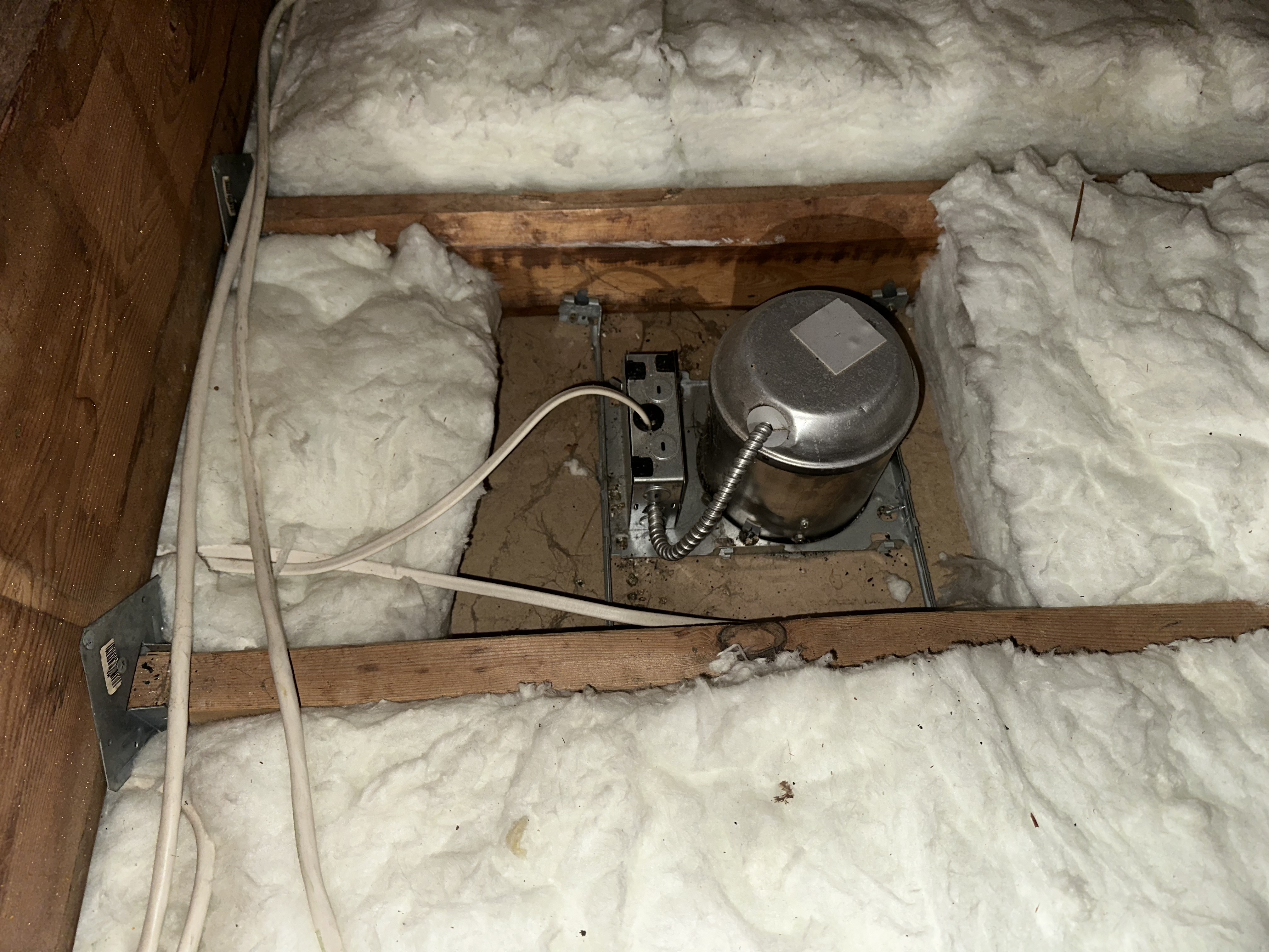

Upstairs is so drafty and we have these high hats everywhere except most look like this in the attic.
Until I swap these old fixtures out and then blow in additional inches of insulation, can I do a better job without compromising safety or breaking golden rules of electrical work?
Depends: some cans are IC rated and some are non-IC (Insulation Contact is what I was always told; never actually looked it up). Impossible to tell just from a picture.
Open the junction box, and if there isn’t a sticker there that says it, then remove the bulb and trim and there should be one in there.
If it is not IC rated, DO NOT lay Insulation against the housing - not that it would be an imminent fire hazard, but I wouldn’t take the chance.

If they aren’t IC rates you can always place a plywood box over it, then insulated around that, but I would check the light manufacturer specs first.
However, it looks like you have no vapour barrier and only batted insulation between your ceiling joists. I don’t think you will find a noticable difference by just addressing your potlights, unfortunately.
LOL, it looks like this is your fixture. Having said that, pop the JB cover or look for IC rating inside the can as JK said.

Best bet is to purchase covers, air seal them with high quality caulking and then insulate around the cover.
You will want the covers anyways before you blow in any insulation. Buy some fireblock foam and start looking for any other electrical penetrations while you are in the attic. Don’t forget any other electrical boxes, fan and random light boxes. Those will let a bunch of air in.
