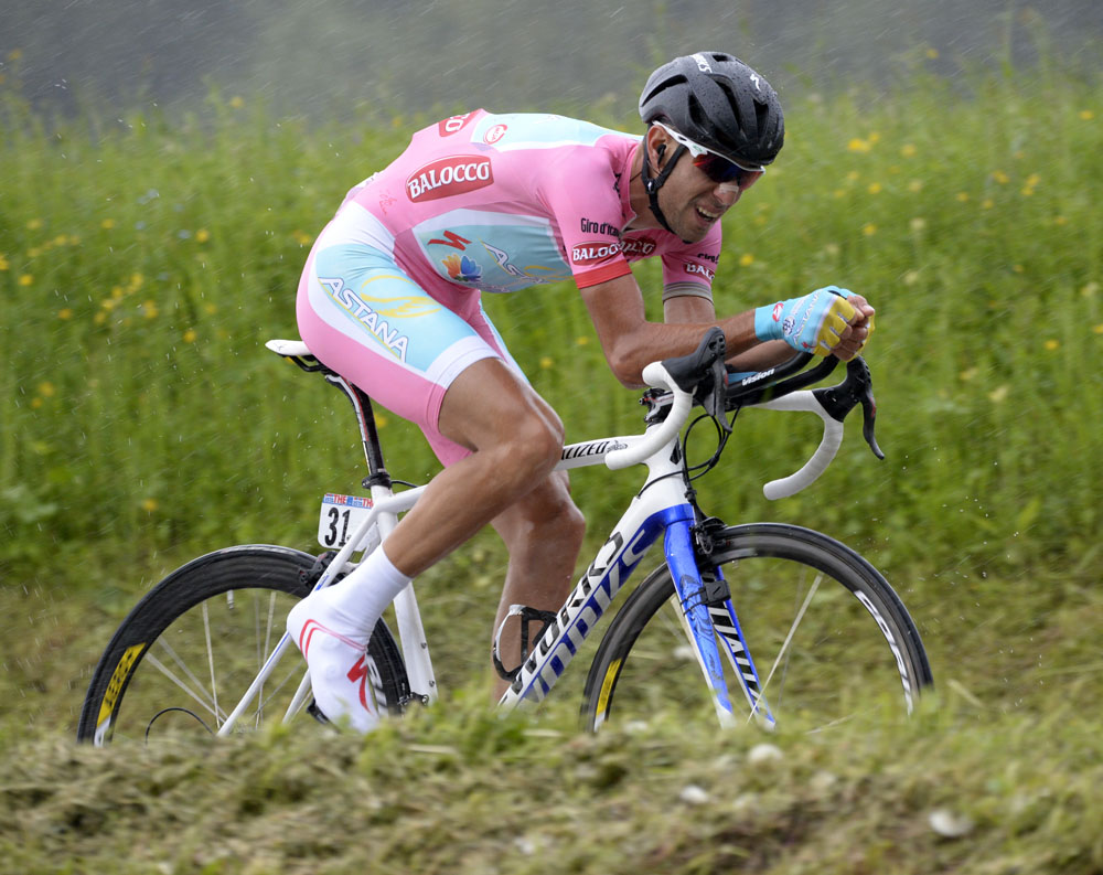

Aerobars are the single best speed upgrade you can make to a bike.
A tri position on a road bike will put too much weight up front (poor handling, and arm fatigue when supporting your weight on the hoods/drops).
Road position with tri bars (better alternative IMO) will either be a more choked-up “big slam” position, or have you sitting out on the saddle nose (ok for short periods, but not very comfortable).
Slam
http://cdn.triathlon.competitor.com/files/2012/04/262-635x421.jpg
https://encrypted-tbn3.gstatic.com/images?q=tbn:ANd9GcQB_4JgC2q92h93ajI6o4LZFjPctgC8Ln78FWd2DImRpYIO7qghSw
Nose riding
http://cyclingweekly.media.ipcdigital.co.uk/11141/00000a6bc/b7f0_orh100000w575/giro13-st18TT-nibali.jpg
