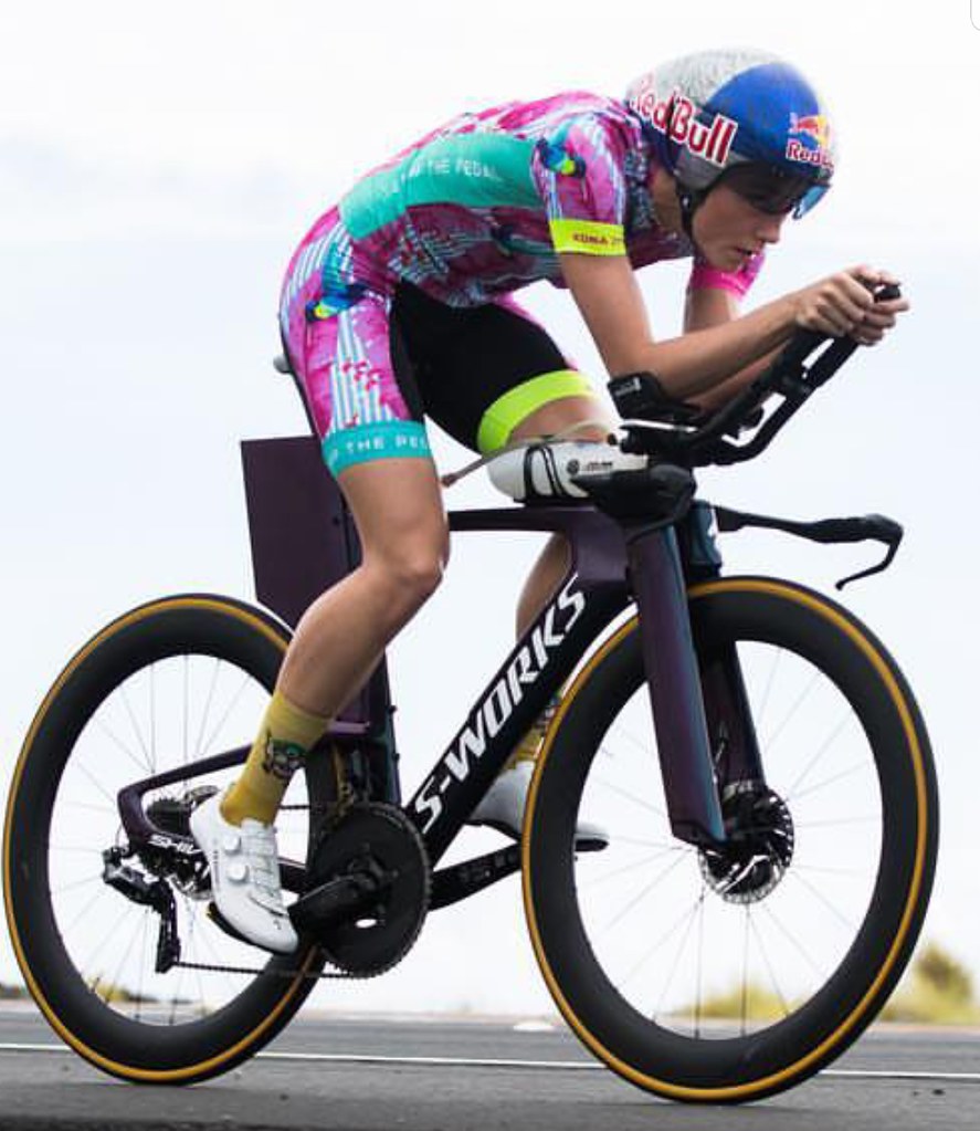

I got the recommendation that this BTA would fit on the Shiv (current model) in a different thread, which I unfortunately cannot find right now. However, trying to install it today, I cannot see how it would fit; not BTA due to the built in straw, not on the top tube due to the PD bottle being too long and reaching beyond the steering column.
I am I misinterpreting the advice I got, i.e. has anyone got this to work? Or are there other e.g. Profile Design or XLAB BTA systems that do work?
Based on image, at least XLAB Torpedo on top tube is doable.
How does the straw stop it from being BTA? Do mean the Shiv bladder straw?
Correct, sorry if being unclear: BTA mount is not possible as the required position would cover the bladder straw and the hole from which it protrudes.
