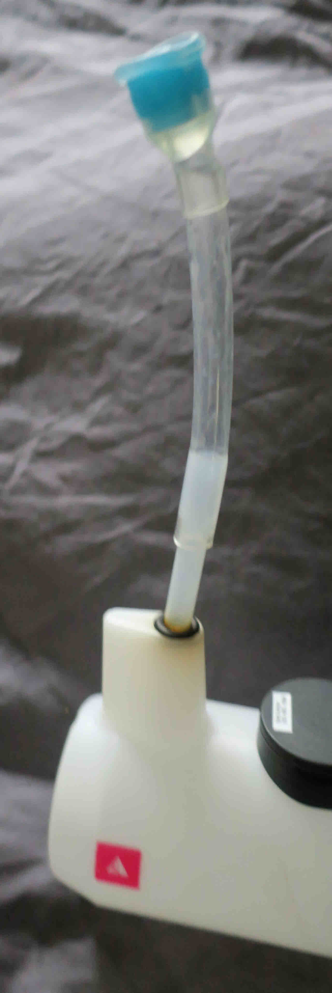

I inserted a couple of photo but guess don’t know how to do it right. Came out too big.
I added a rubber grommet because I didn’t like the way with liquid would still slip out between the straw & bottle wall when going over bumps. So I then
I made my own straw & it has worked well without leaking.
The bottom tubing is 3/8" OD translucent tubing & the top part 7/16" clear vinyl tube that the bite value I like slips over.
The rubber grommet size is 5/16" x 7/16" and it fits nicely into the bottle.
