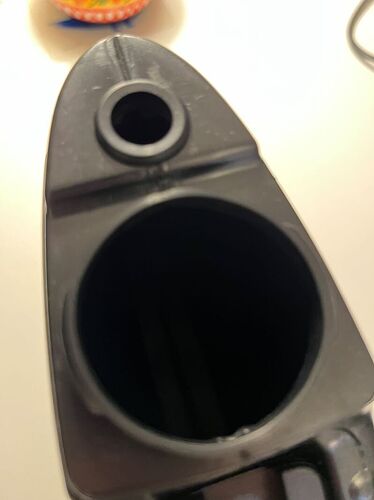

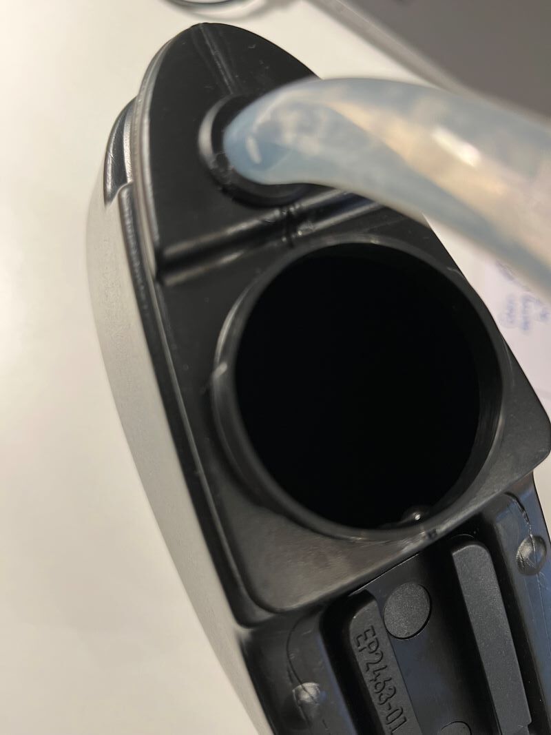

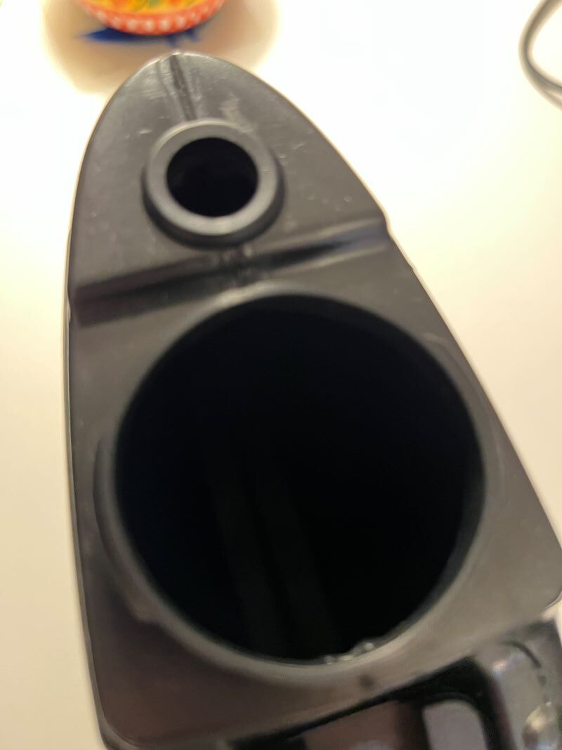

Can you pop the top cover off and show the straw hole please?
In that top photo it looks like there is water 2cm up the straw above the top of the bottle? If that is the case then is it negative pressure in the straw (bite valve) or somehow positive pressure in the bottle?
Is that ‘flask’ mounted firmly or does it wobble? I’m not familiar with the Canyon specifically, but that gap between the upper part and lower part in the bottom photo doesn’t look quite right - Just wondering if that’s causing some excess movement that is related to the increased amount of fluid coming out the top.

@cyclenutnz I hold to the hope yet, but it’s already pretty thin :wink: Here are the photos, let me know please if anything else is needed:
@Duncan74 the water is in the straw is because I wanted to check if i can freely drink once the sponge is in the cover, never observed any negative pressure with it.
Regarding wobbling - yes it does a bit by design, there is a space petween the thing and the frame: Canyon even adds the transparent sticker to put on the frame in that place to protect the paintjob. The strange thing is that in the kitchen test i did a lot of shaking and it seems to leak only on the bike, so not sure if that little wobble does it, but will try to add a small bumper inbetween to elimate the move.
