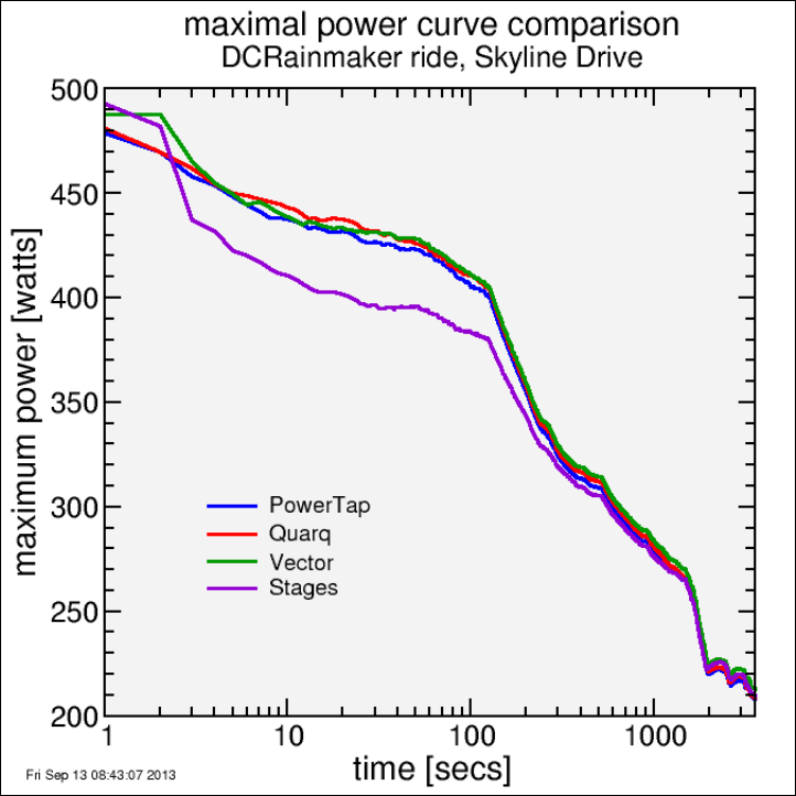

could you use WKO+ or Golden Cheetah to make a mean maximal power chart from each power meters data from the ride, and upload the data?
or if you like, you can send me the power files and I can do that for you.
PM me and I’ll send you my email address

No, it isn’t, but while the average power for a 3 hour ride may come up relatively close, most days, sections within that 3 hour ride can be very different. That is something that the MMP chart can sometimes reveal quite quickly.
As you say, it is important for training and pacing, if there are intervals or hard sections in there where data is very different, that may be bad. This can also effect NP quite a bit more than AP, which can affect people who use TSS to track training load. The extent to which this is a problem will vary from person to person, and day to day, and how they use their power meter.

I would be really interested to see the file if Jackmott gets the data to produce it.
Always remember - even if the file shows great differences in places, there is nothing to say the powertap is right and the stages is wrong. Might be the other way around.

You personally may not want these details – which is ok. But asking to understand the conditions under which they differ is hardly a left-right leg debate. Standing climb, sitting climb, low cadence, high cadence… it’s really good to know when things differ.

Who would forget this fact, though? I would like to see where they differ, that’s all.
http://www.dcrainmaker.com/images/2013/09/max_power_curves_thumb.png
