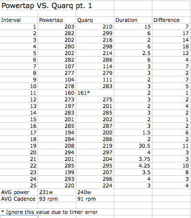

I tested this last year running both PM at the same time. Over a 2 hour ride I took intervals on the garmin.
http://i799.photobucket.com/albums/yy277/Amacphai/PowertapVQuarq1.png
You can see at the end of my ride the quarq averaged 9w average power higher.
I understand where the difference in power comes from, but why is the average cadence on the Powertap 2 rpm higher than on the Quarq?

The powertap doesn’t measure cadence. It estimates cadence based off of the torque surges of each. The Quarq measures cadence directly. If you look at the raw data, the powertap cadence estimate jumps around quite a bit. As the data points out, over the long haul it gets pretty close.
