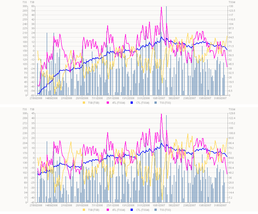

Just to emphasise my point, following is a picture of the same Performance Manager Chart for an athlete covering a 7-month period from September through March with the only change being the seed value. In the top chart the seed values for ATL and CTL are zero, in the lower chart both ATL & CTL seed values are set to 40 TSS/day.
http://i220.photobucket.com/albums/dd226/ASimmons/PMCSeedingExample.png
As can be seen, starting at 0 CTL may show an artificially high ramp rate in the first month or two (especially if you have already been training). But it starts to settle down so that the charts essentially match after a few months.
In the case of this athlete, they had not ridden a bike for ~ 6 months due to serious health issues, so starting at a CTL/ATL = 0 zero was appropriate.
If you have several month’s of TSS data prior to the start date for a chart, or say are starting a new chart for a new season, then there is no need to seed the chart - it will pick up the historical ATL & CTL starting values automatically.
