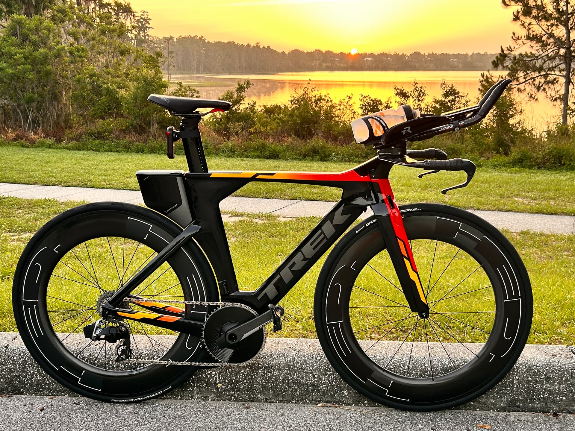

Hi there. After 11 years on the same race rig I’ve got the bike itch. However, given the prices of the new crop of tri bikes I’m curious - how much time saving are really there?
I’m currently on a fairly “optimized” 2014 Speed Concept. Vision Metron bars w/Profile ASC extensions, HED 90/disc wheel set up w/GP5000s and latex tubes. 23c. 12spd SRAM AXS. Would moving to a more current bike setup gain any noticeable time savings over the 40K distance? My split is typically around an hour for that (if that matters).

I swapped from an Argon E114 to a Trek Speed Concept last year. Argon was very much not optimised (position was, bike wasn’t), and was a gen before your bike. The difference has been huge in both performance, comfort and practicality of carrying tools/food.
Ability to run tyres wider than 23mm I think is a big factor on the rough roads that I ride on.
I just have more ‘fun’ riding the new bike and given this is a hobby then that’s a massive thing that I really think we shouldn’t overlook as a benefit.
My gen3 SC is not faster than my gen2.
I still race on the old one, train on the new one.
Both are comfortable, and I don’t mind the rim brakes for races.
Rim brake bikes are far easier for airline travel box and build.

Always. But again - I train on the disc brake SC with 28’s all around. A little more comfortable. The 2nd gen is basically my race-only bike. Shakeout rides and races, then thoroughly cleaned and put away for the next one.
