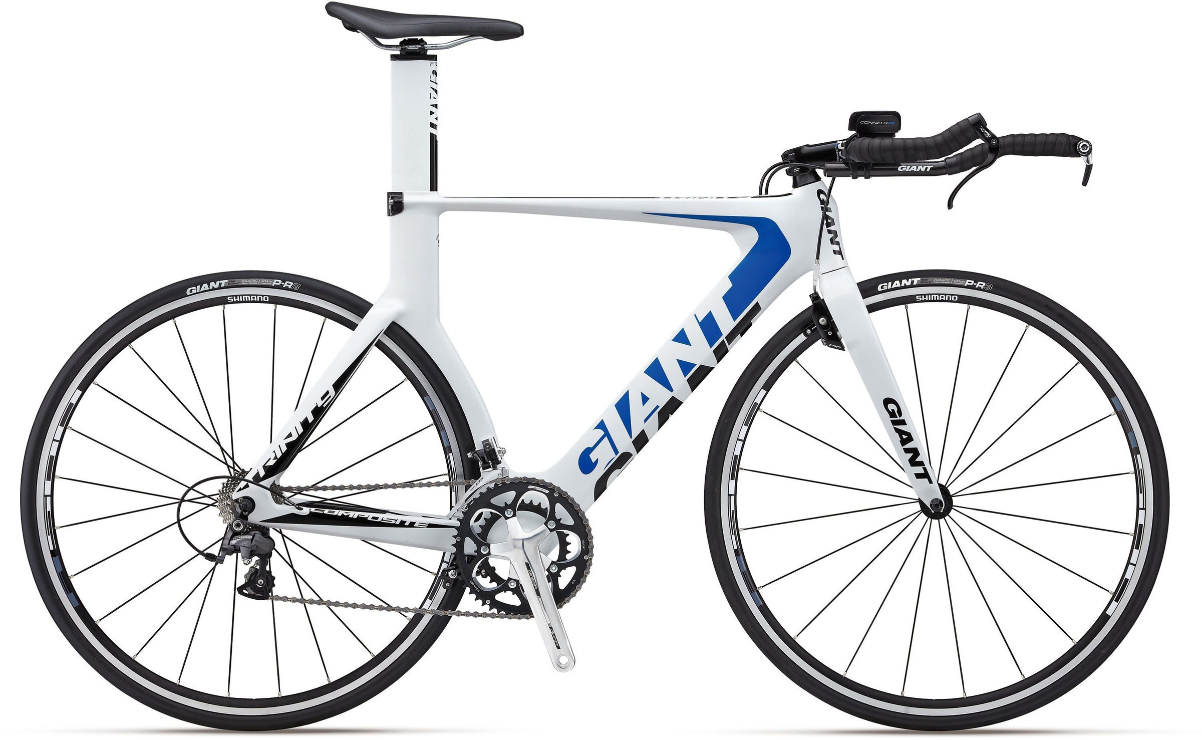

Seeking advice from the bike experts. I have a S 2012 Giant Trinity, that I’m rebuilding (first full build I’ve done). The frame is fine, I see no reason to replace it. However, I cannot stand the hidden front brake. Sure, it might save me 5 watts, but it’s a nightmare to work on. Last year I think I lost more time due to brake rub than aero savings. I’d like to replace the fork with something comparable, but I’m not sure what measurements come into play. Are all “road forks” created equal? If not, what angles and lengths are relevant? How do I find the measurements on my fork as guidance?

Looks like a standard 1-1/8" fork. The later model Cervelo ones that were on the P2s and P3s of that era are probably the best, but a 3T Funda is good also.
https://www.sefiles.net/images/library/zoom/giant_trinity_composite_2_12_z.jpg

Basically, road forks come with different rakes to go with the frame’s intended handling characteristics.
Rake (offset) and the crown to axle length will vary slightly, but not enough to worry about IMO. Make sure it’s made for the right wheel size.
Last year I bought a 3T Funda after my other fork broke. The seller didn’t know the offset, and it ended up being 53mm vs the 43mm my bike had before (~43mm is much more common). I didn’t notice a difference in handling, but did notice that I no longer had toe overlap… which was great!
