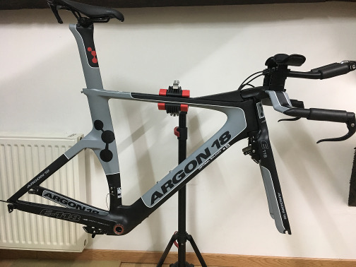

Please help Identify this frame
Hi Guys and girls,
I’m new here (So hello to you all) and came across this site/forum whilst trying to fathom out what the hell I just bought…

Anyway, then I started looking for an engraved serial number on the frame, difficult due to the previous owners respray. I looked online and have come to the conclusion it is not an ARGON 18 E118 Next as all the decals on it say. So what is it? Anyone got any ideas please?
More pictures, please.
Definitely NOT an Argon E-118. None of their annual iterations of the frame had that shape at the down tube, head tube, top tube junction area. Very close, otherwise. The stem looks a little different than any that I can see as well. I’d say Chinese knockoff frame. Looks like an E-118 and a Specialized Shiv mashup. Checked every Chinese knockoff site that I know of and don’t see any exact matches there. No idea what animal this is.
Looks nice, though. Bummer.
I asked the Argon product manager to look at it. He thinks it’s a fake
The area behind the head tube doesn’t look like a typical E118 frame. The legit frames have a more square look to the junction between the head tube, top tube, and down tube. The seat post also looks different from a genuine E118 frame, particularly around the unique circular clamp that Argon has. The bottom of the fork also looks different.

I’ve also looked for some generic TT frames. The FM069 is close to the frame that you have in your picture, but it has noticeable differences in the carbon (like right around the seat tube / top tube area, and where the seat stays join the seat tube). I can’t quickly find a generic frame that exactly matches what you have pictured.
Like the other poster mentioned, post more pics of the frame and wheels
At the same time, I can’t find an obvious
The front end looks like a boardman TTE 9.8 - sloped toptube behind aero bars

The frame has got to be fake. It’s got features that are very similar to the E118 that I can see in pictures, but has some distinct differences that i’ve never seen in an E118.
I believe the OP got confirmation the frame is a fake,
