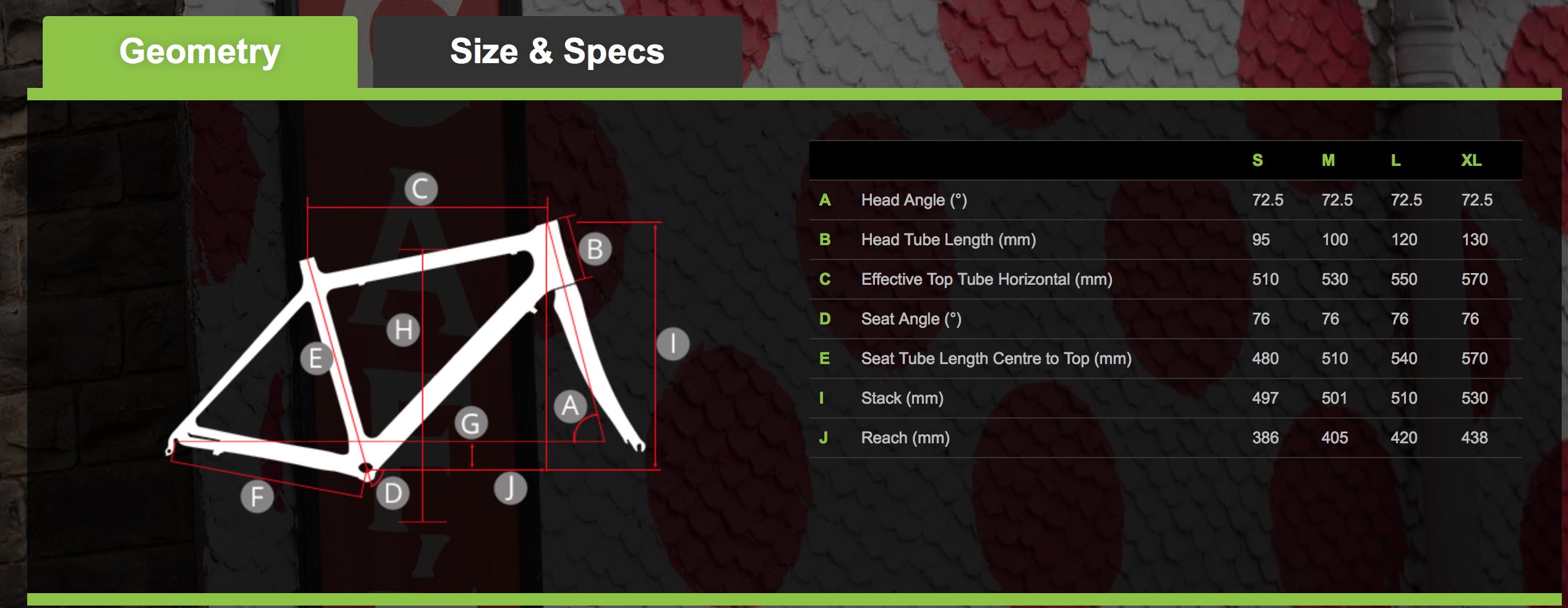

Do you think the XL frame size is suitable for my height (5’11)? Planet X recommends a medium sized frame but as you can see on the photo, the stem is adjustable. Plus, the top tube length is 57cm which is similar to a large size road bike frame. Currently I ride a 56cm as a hybrid bike.
Well, very hard to know 100% for sure via the internet, but it appears that, yes, an xl might be a better fit for you based on the measurements that you gave and that you will be running this as a drop bar bike.

I suspect the answer to the XL fitting is what your proportions are. I’m 6ft and a quarter inch. I ride road bikes with anywhere from a 57.2 to a 58.5 effective top tube with stems of 120 to 130mm. My femurs are short so I’m a little farther forward than most on my road bike. The head tubes on my road bikes are 175 to 185mm.
The previous responder who say you’ll be fine but may need a shorter stem is most probably right.

Attached is a photo showing the geometry of the frame. This is for the newest Planet X Stealth Pro frame but I think they haven’t changed.
